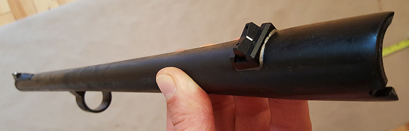

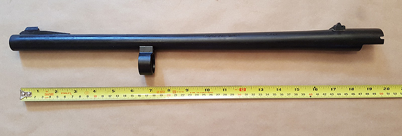

Remington makes 20" barrels with rifle sights for the 870 and with rifling and without.
They also make a cantilever rifled version to mount a scope ....
