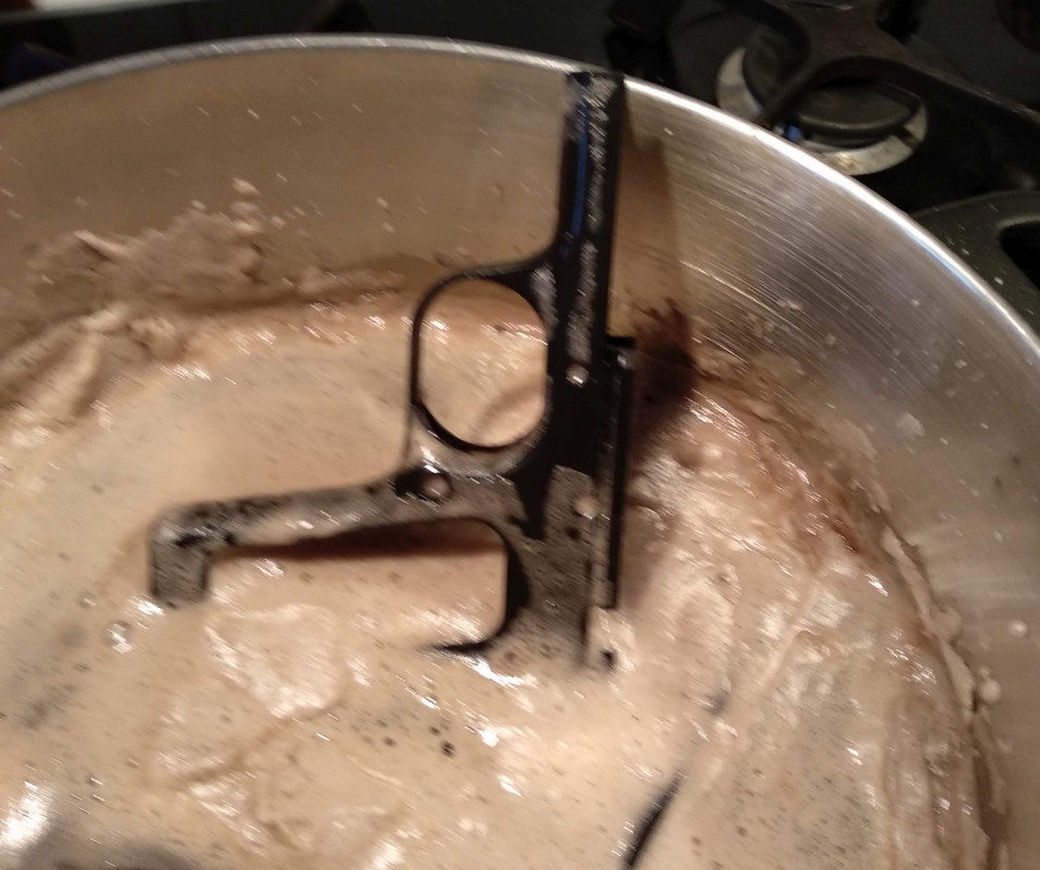

For TT you might consider hot bluing with Stump Remover as described here https://www.reddit.com/r/guns/comments/2bgcvd/diy_home_reblue_stepbystep_nitre_blue_in_your/
It's a pretty straightforward process and if you're not satisfied with the results, you can always re-blue using the same materials.

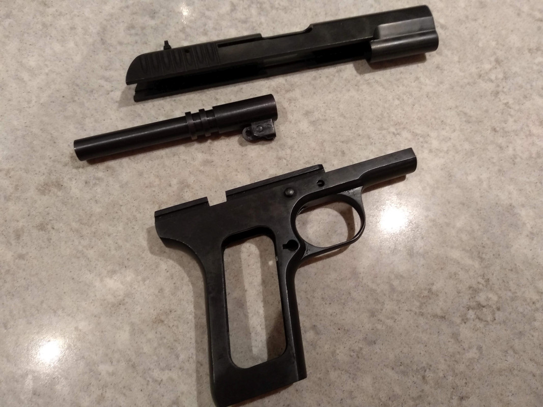

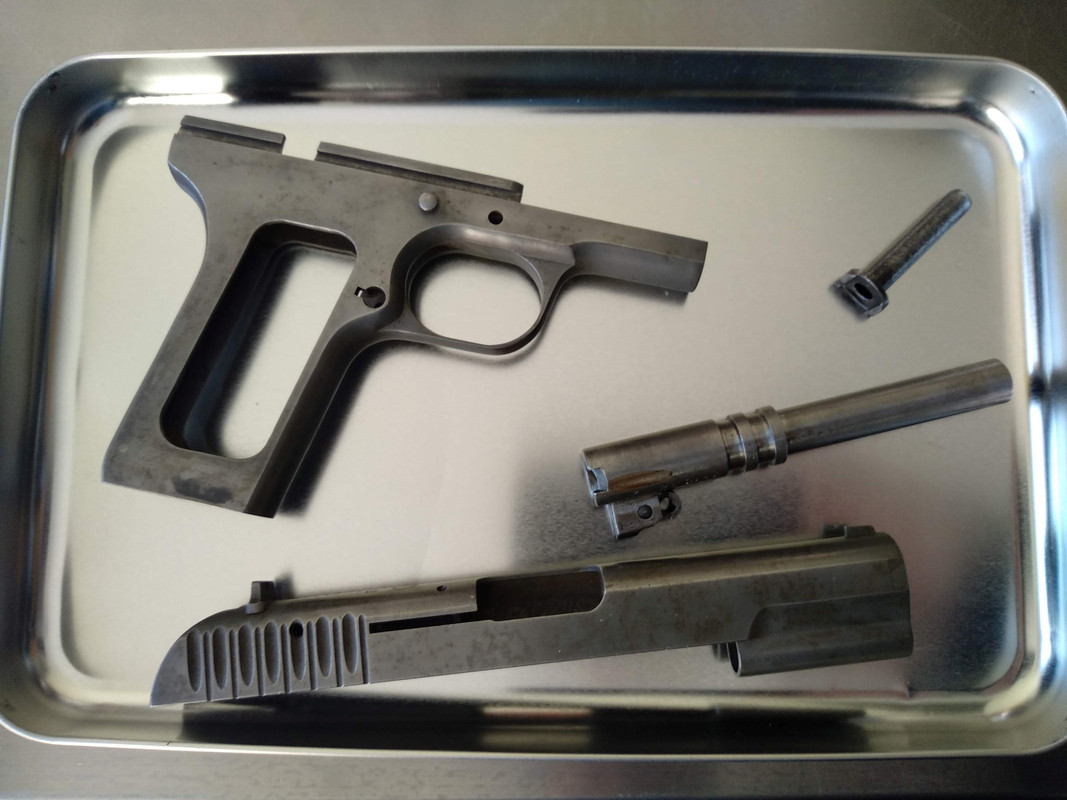

TT parts are small enough to be put in the used pot. I did it with one of mine turned out pretty well

Did you take the hammer assembly apart and do that too?
The hammer assembly was in decent shape so I decided not to do it.
It can be done though, just have to figure out how to insert/remove it to/from molten salt. The thin metal wire should do, I used it for smaller parts.
