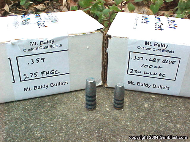

Well then, look no further than a 250 grain cast bullet with a big flat cast meplate. Design your own bullet at http://www.mountainmolds.com/ - something like you see on that splash page, but in the appropriate weight and caliber. Or ask Dan to design one for you. Or me... or somebody who's done it a few times. Or, stick with an off the shelf design - about all you'll lose is that wadcutter meplat. The RCBS 35-250-FN is a pretty good bullet at a very good price, but the flatter the meplat, the more impressive the performance. Something like this:
It's not difficult to get a 250 grain cast bullet shooting well out of a .358 Winchester at around 2500 fps. That will knock anything you run into at a 100 yards on its' ass in very short order with any kind of reasonable shot placement. We are a generation who for the most part hasn't seen just how incredibly effective well designed cast bullets are. They leave nothing to be desired when long range isn't the name of the game - and they cost as much as dropping by the local tire store to beg a bucket of used wheelweights.
I like the Barnes for anywhere, anytime shooting. But if I was given a .358 Browning BLR and a 250 grain bullet mould to do my hunting with for the rest of my life, I wouldn't have much to complain about.

Higher velocities with cast bullets primarily depends on
  1. Good bullet to ball seat fit.
  2. Bullets hardened to match operating pressure of the load
Without a good tight fit, you'll get gas blow-by and leading.
Too hard of a bullet, the bullet won't fully obdurate and once again you'll get blow bye and leading; too soft and it won't hold up to the pressure, you'll get gas cutting and yet again leading.
The single best resource for anybody interested in bullet casting is membership in the Cast Bullet Association and subscribing to the email list.
