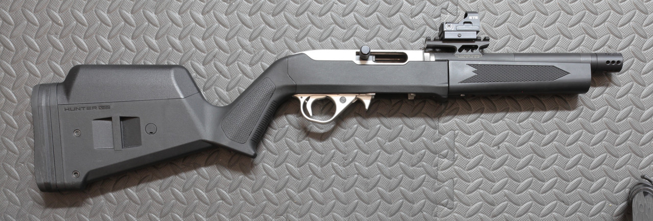

I love short barrels, but I get that this is not for everyone, my favouite is the Adaptive tactical 9". I also love my 20" Kidd bull barrel.

Here is the Adaptive Tactical 9" barrel on my 10/22 TD:

It was probably user error, but it happened to me more than once. The outer core of the Kidd buffer is very soft rubber and can get slightly distorted (it gets hung up on the receiver and bulges slightly) and prevents the bolt from cycling all the way back - leading to jams. This was mainly a problem during extreme rapid fire during steel challenge shooting. It happened on the rifle shown in my third pic. As soon as I got rid of the Kidd buffer I never had the issue again.
