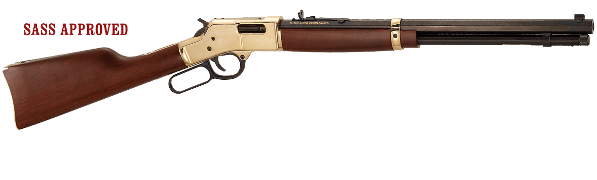

how are the Henry rifles? Anyone know how the quality and accuracy is? I believe I saw a real beauty with the octagon barrel and gold trim. I would take one in 45 Long Colt.
http://www.thetruthaboutguns.com/2011/08/chris-dumm/gun-review-henry-big-boy-44-magnum/
http://www.henryrifles.com/rifles/big-boy/
Henry Pros:
- nice looking fit and finish
- smooth action. It's based on the Marlin 336 action, but the steel on brass slides smoother than a marlin
Henry Cons:
- heaviest rifles in their class. The massive brass receiver is heavy and the barrel has a LOT of meat on it.
- Mag tube loading. Not that fast to do and in the opinion of many is a feature more befitting a .22LR.
- Cost - they are among the most expensive guns in their class.
I think that about covers it. Henry claims their receivers are as strong as steel, but I have my doubts about long-term durability if you shoot full-house .44 Mag or .45Colt hotrods in your Henry. It's interesting Henry only offers their .45-70 version with a steel receiver and the steel receiver version of their .30-30 outsells the brass version.

All you need to know is how they shoot and feel... Henry's are the sweetest shooting lever action rifles that I own, bar none...
My comments aren;t meant to slag the Henry - they are nice guns. I was trying to be honest and factual and I think I got the pros/cons just about right. Weight is an important factor - frankly, I'd WAY rather carry a Win 92 than a Henry if I have to walk/stalk a long distance. YMMV.
They are a slick and sweet rig at the range though.
I'd be carrying it more then shooting it. Mostly 2 weeks a year while scouting for bear and wolf. I've walked up on smaller bears and wolves often enough and on nice days a nice light pretty lever gun seems just right. Right now I carry a sxs in 45/70 which I'll continue to carry most days. Life is to short to hunt with an ugly gun!
For compactness, reliability and function the Browning 92 in 44 Mag is superb. I wish I had never sold mine.
Based on that, a Henry is not your gun... they are heavy suckers... personally the heavier weight is one of the things I love about them, but certainly not everyone feels that way... in addition I prefer the tube fed magazine... I made a speed loader and the bullets don't get damaged on loading as they often do when gate loading.
I think the Win 94/92 or Browning 92 would fit your requirements nicely... as mentioned above, they can be case hardened if you just gotta.
I never thought of that. The tube magazine is one of two things that puts me off considering the Henry. The other is I don't like the brass being so bright and shiny, though I'm not opposed to brass itself. Does it dull if you leave it alone?
There is no perfect solution, right now the Marlin 1894 seems to be the compromise I dislike least in a lever action. But the things you like about the Henry are things I could like, too.
The brass can be dulled down or shined right up based on what you prefer... the heavier Henry, feels SO solid in off-hand shooting... it has that "I can't miss" feel to it... and the way my son and I smoke the clays with them only bolsters confidence in using them... I am loading the 225 FTX over H110 for them (and my Ruger 77/44's).
