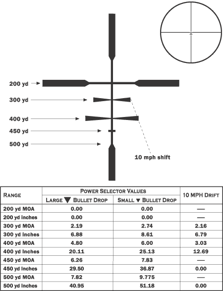

I bought a Leupold with the boone and crocket reticle by accident a few years ago. Turns out I like the reticle and it works quite well.
I just bought a VX-3 2.5-8x 36mm on the current clearance sale with a Boone and Crocket reticle for $553 and there is a $100 US rebate to come so it will have costed less than $450 in the end, not too bad for a very nice scope.

The cheapest Leupold with a BDC (VX-1 with LR Duplex) will set you back closer to 400 bucks before taxes.
