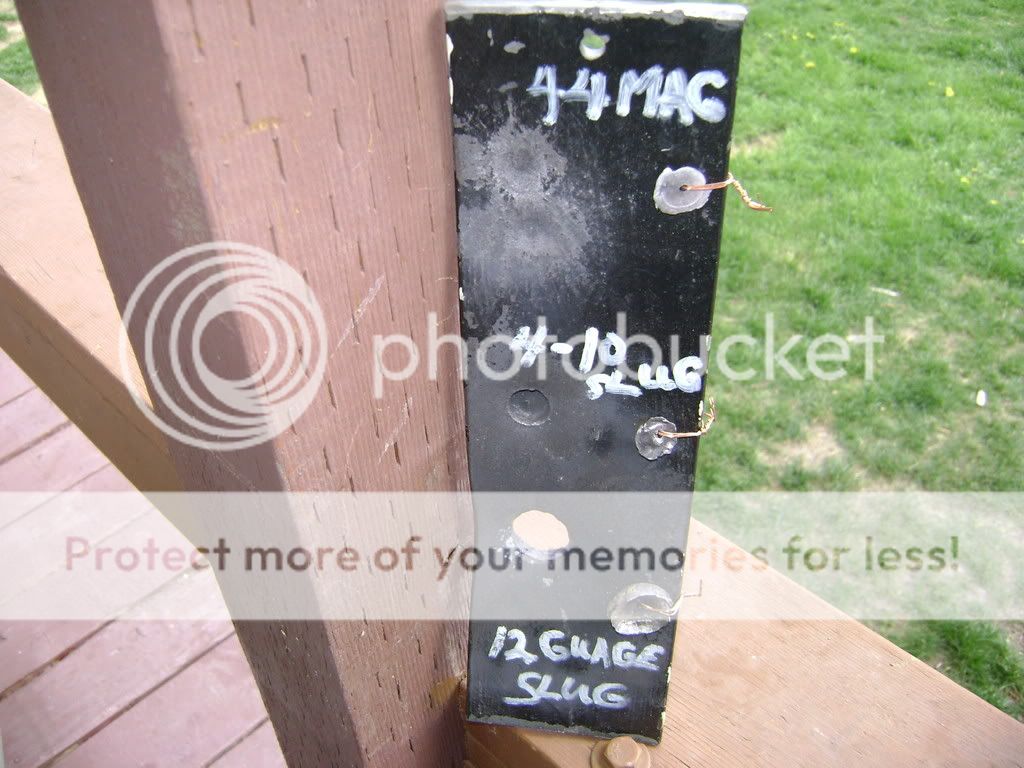

1/4 inch flatbar pointblank
my friend made this for me,i know,he cant spell:D
