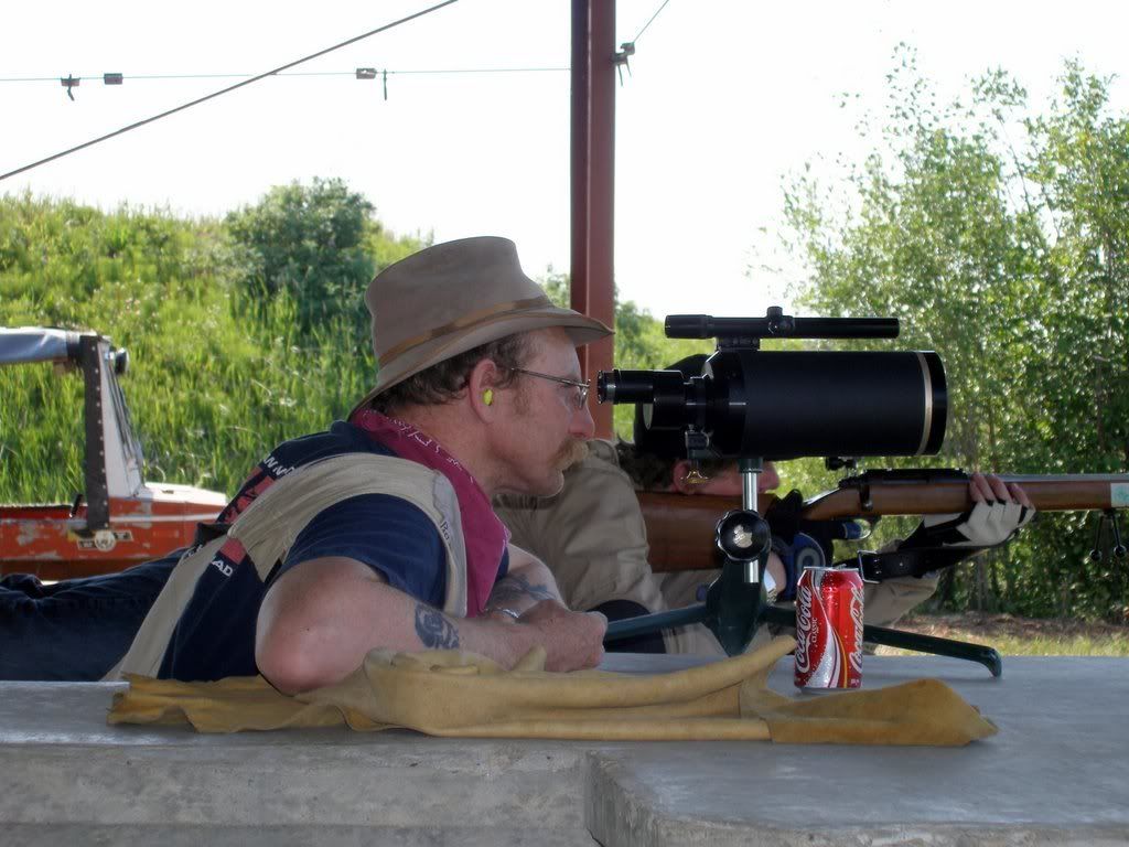

A matter of rules for long-legged tripod models, not the busty ones, is several disciplines and ranges have a set amount of firing line space per shooter. While those long, slender, tapered legs are ever so tempting, some shooters have to depend on short stumpy low maintenance ones that don't crowd out out the neighbours.
My son and I use a pair of Freelands that have been in the family since the 60's, and they are a solid piece of gear.
I guess they are actually BIPODS, not true tripods, because they only have two legs.
I find the rig a bit flimsy in big winds ofr my overly large 40X, but the 20X Sentry we use for smallbore position shooting works well.
For those that have never seen one, here is a few pics of the bipod set up on a bench.
