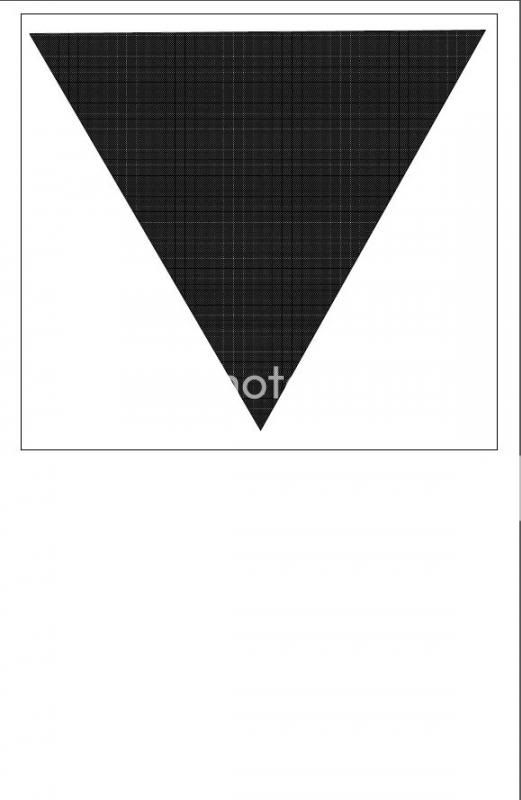

I use 6 inch sided black triangle with one end pointing down.
I print it on 8x11 white paper and staple it at 100 yrds on biggest white sheet i can get.
With some practice that target really helps me with developing loads and fine sight adjustment.

I print an inverted triangle on 11x17 and aim for the bottom vertex of the triangle.

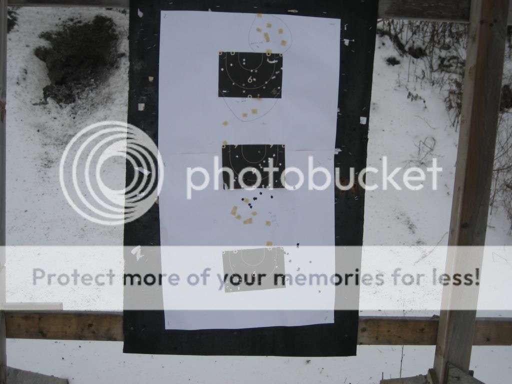

I staple the diagram to a big sheet of paper and capture the groups on the backer, re-using the black many times.
