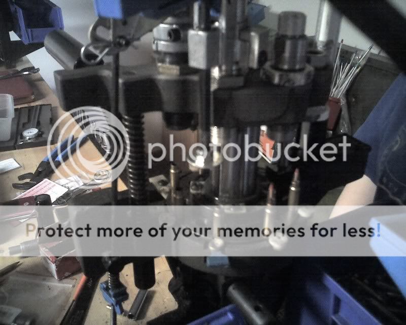

Just found what my holy grail would be...
A Dillon 1050 fully decked out to load 5.7x28.
Copied from the original poster of the photo...
"A lot of modding went into this machine, 1050 shellplate for 5.7, which cost several thousand dollars, a custom plate for the brass feeder, custom swaging rods, custom primer feeder, custom powder measure pieces (to handle the heat buildup from the speed) custom dies, and a custom crimp die."
All in all, he had over $14,000 in machining costs into the press itself, not including the bullet feeder or the automated motor drive.
Press was rated at just under 2000 rounds per hour if the operator did his part.
A little rich for my blood, but just amazing to behold.
