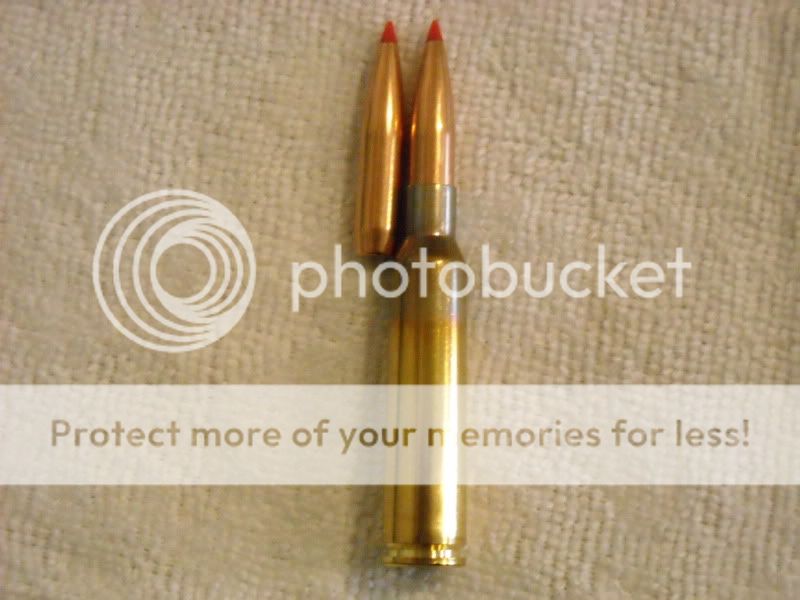

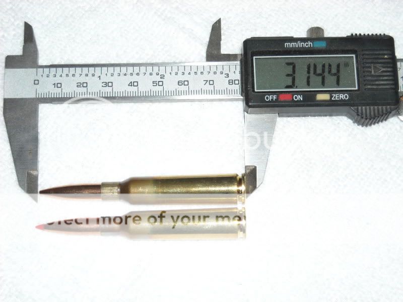

I think 6.5x55 is also an awesome LOOKING cartridge...book length is 3.025", these are longer to reach lands. Top is Berger VLD, bottom is Amax, both 140gr:
You'd think there was hardly any bullet left in the case right? BZZZZT wrong :)
