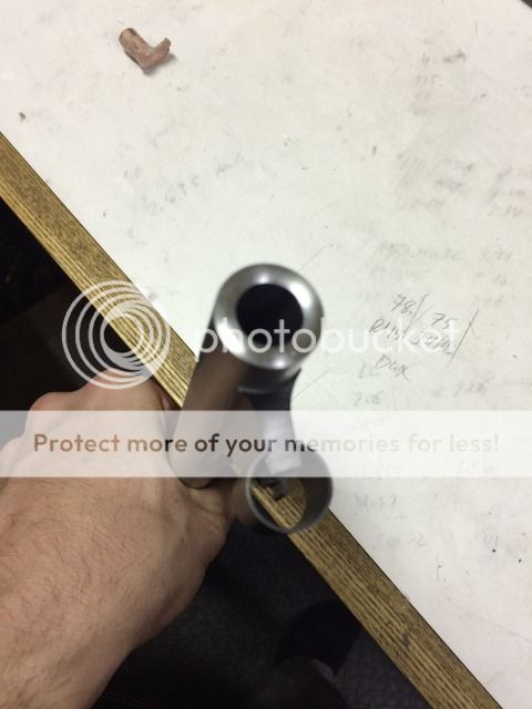

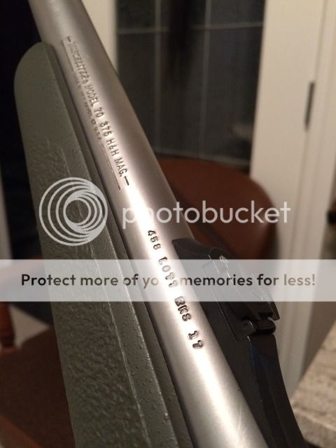

Ive had a Model 70 Stainless Classic in 375H&H for a while now. It was a good shooting gun but was too front heavy to be useful in a 375 IMO.
I was originally looking to get it rebored to a 416 Rem but the 458 Lott seemed like an even better way to drop weight.
So I sent it off to Ron Smith for a rebore and barrel chop to 22".
He did a great job on a 22 to 12 gain twist rebore to 458.
The gun weighs 9.4lbs scoped now and is properly balanced to feel even lighter.

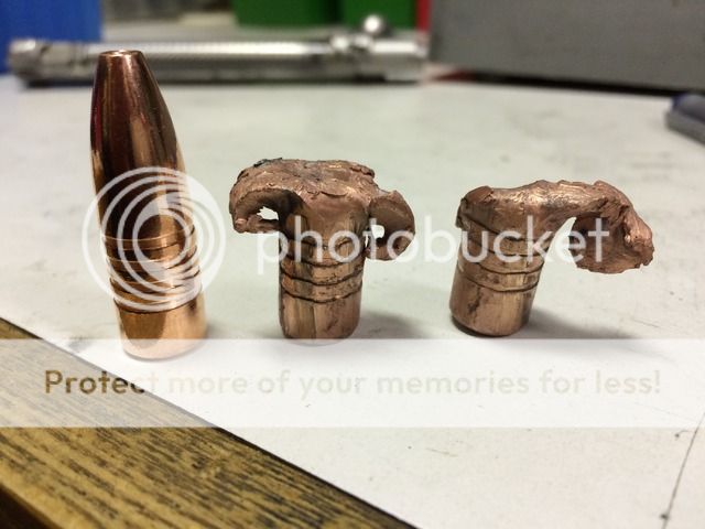

Also, I recovered a couple TSX's from the earth/gravel berm with recovered weights at 400gr and 340 gr each. Tough bullets!
