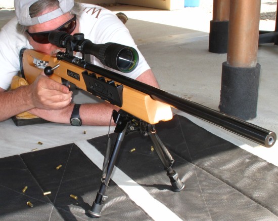

Try shooting groups with the pod loaded and unloaded and see how the groups form. The pod in the post above is mounted so the legs fold backward.
This doesn't allow the legs to flex with spring tension. Probably not critical for that rifle(rimfire) but may affect performance with a HP rifle. A pad under the feet as shown is beneficial to reduce deflection from recoil off hard surfaces.
Please define backward.

And as such, the Harris bipod in the above photo appears to be mounted properly!
