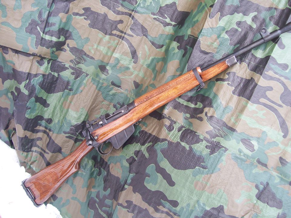

I redone a J carbine a couple winters ago. The factory black paint was so worn off & looking horrible, I had to do something. I wire brushed all of it off, then sanded the metal smooth with 180grit, then 400 wet, then buffed with the Black stone. I then heated all the metal & Blued it 7 times. It turned out soooo nice.
Lone Ranger that looks very nice!!!

I like cold blueing. And it looks good on yours.

I heated all the metal parts before bluing. It takes the blue much better. I just used a propane torch. just hot enough to say ouch when you touch the metal.
