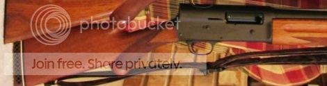

I found a picture of a collection of Browning Auto-5's and one really jumped out at me
I PM'd the guy and he said that he had both the bolt and lifter "plated" by these guys with Black Oxide http://www.techplate.com/black_oxide_coating.htm They're in the States though, and that usually opens up another can of worms I don't want to deal with for this project.
