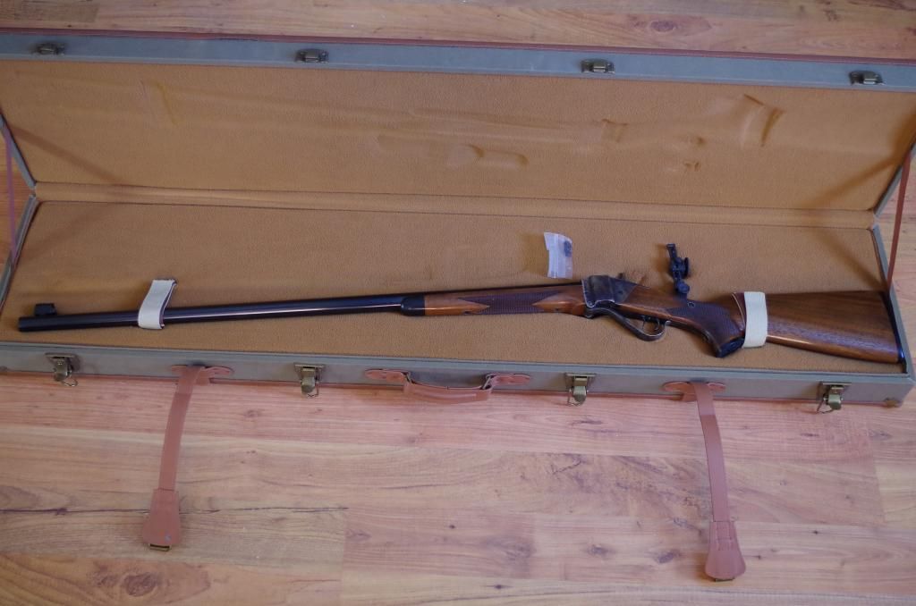

Any one here loading and shooting black powder cartridge rifles? I have a Pedersoli 1874 Sharps chambered in 45/2.4" (45/90) and it is a lot of fun to reload and shoot. I'm just wondering what firearms other people might have, if you shoot competitively, whether you load black or smokeless and what bullets you use.
