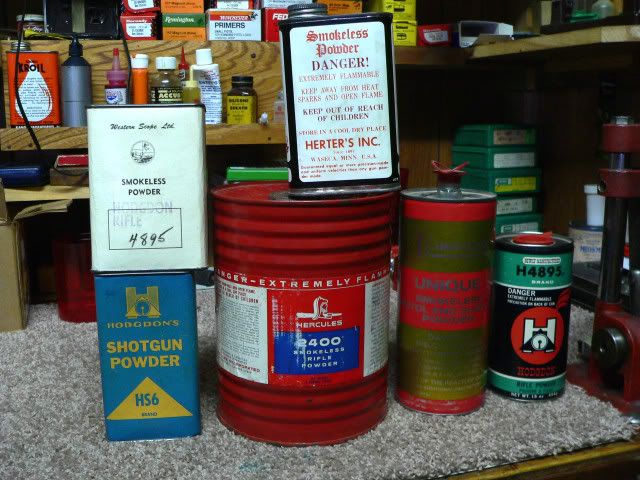

Bearhunter, do you have a chronograph? I don't have one now and was wondering if you have one if we could get together and try out our WW2 powder with the chrony, to see how it is still doing?
I earlier stated my old H4895 had nothing else written on the cardboard container.
In looking at a picture I took, I see it was packaged by Western Scope. They were a sporting goods wholesale outfit.
You have a lot of mighty fine powder! Those sealed up square tins of Hercules 2400 and Unique are really neat.
Wow, what a lot of shooting in the barrel of Hercules Bullseye.
Those Hodgdons with cardboard and tin tops and bottoms, were probably no newer than 1960s.
It all looks in perfect condition, must have been stored properly.
So, as I said in my first post, I would conssider it as being newer powder!
Lucky you.
