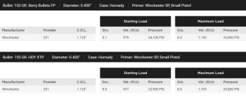

The 40s&w I’ve reloaded before and didn’t have any problems, it was being fired out of the same gun as well, a smith and Wesson m&p40 first gen, but this time it felt like someone was throwing sand in my face after each shot, I checked the gun and didn’t see any broken parts or dirt that could explain it away, also I clean my guns after each range trip so not dirty in any way

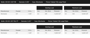

The 45acp I haven’t reloaded before until now and was getting the same thing, like sand in the face, also it wouldn’t cycle properly, not ejecting spent cases which I assume means it needs slightly more powder in that gun, a tisas 1911a1

You are being hit with unburnt powder, not much else it could be. They are both pretty light loads from what I have used in the past. The .45 has a lot of room to move up especially. Campro bullets are decent but they don't provide the same resistance as jacketed bullets, increase your powder charge or use a magnum primer for starters.
Also, last I checked LEE data was just lazily plagiarized from other sources. Buy a manual or two and cross reference with Hodgdon and similar sites.

Both those loads are basically the minimum charge according to the Hodgdon site. I never load the minimum charge, even if I'm testing a new powder. This is something new reloaders often do because they're scared to load anything other than the minimum charge. This normally leads to rounds which are very sooty with a lot of unburnt powder. HP-38/W231 likes to be pushed a little. When you do, the accuracy gets better and the rounds get cleaner.
P.S. Although this doesn't apply to your current issue, be aware that if you're using ancient data (and I mean ancient) that HP-31 and W231 weren't the exact same powder, so you will see different charge weights.
Use the plated or FMJ data for CamPro bullets.

Loaded the 45acp with 4.9gr of HP-38 and it cycles perfectly now but I still get a little blow back so I’ll have to play around a bit more on the next batch
The 40s&w I loaded to 5.3gr and no longer get blow back and cycling perfectly

Bump that up to 5 or 5.3 or so for a mild load that should cycle. You are real low. You are only filling the case about 40%. With a new reloader or someone that has become complacent with reloading, that could accidently turn into a double of 8.4gr. That would put your 700 fps load up to about 1150. Give or take. Don't do that. At 5.3 or so, you would be spilling powder if you double one.
