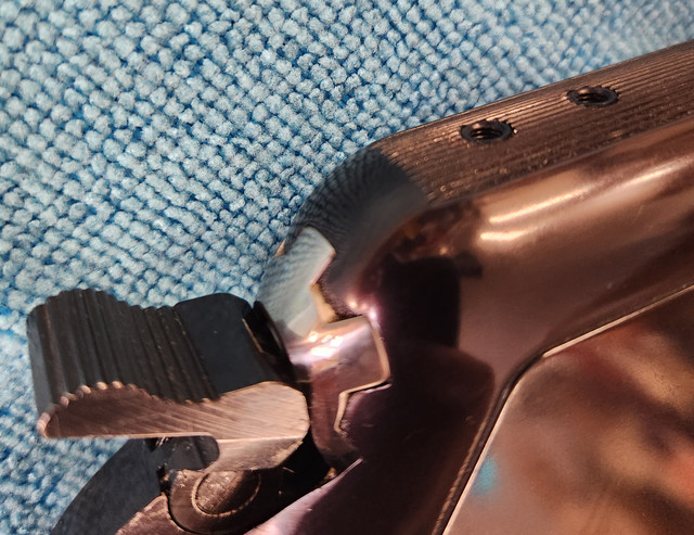

First time owner, just arrived today.
The throw of lever seems way to big.
What could be or is missing or broken ?
It's a short action 243

Does it close fully? Unable to push the bolt forward at all when the lever is against the grip? If so, its OK.

These rifles do not have a short lever throw, if that is what you are wondering. It is the .22 that has a short throw. If the actions cycles smoothly, and the breech closes completely with the bolt carrier all the way forward, it is as it should be.
It does this
]These rifles do not have a short lever throw, if that is what you are wondering. It is the .22 that has a short throw. If the actions cycles smoothly, and the breech closes completely with the bolt carrier all the way forward, it is as it should be.
The 22 is what I'm comparing it to, and snp caps cycle through it and does what you say.
I'm guessing all is good and mystery ( to me) is solved
Thanks all

A better photo to answer your question would be one with the lever fully closed & showing the protuberance of the back of the bolt in relation to the frame. A better visual of the bolt relation to the internal gear train timing can be made.

I see that it is the newer BLR made of aluminum on the reciever. These have a touch more rearward movement than the old steel recievers. Your bolt is fluted to give more surface area to match with the aluminum. When they work well they are great. If you have any problems get a hold of Browning in Montreal. They have a smith that knows how to fix properly.
