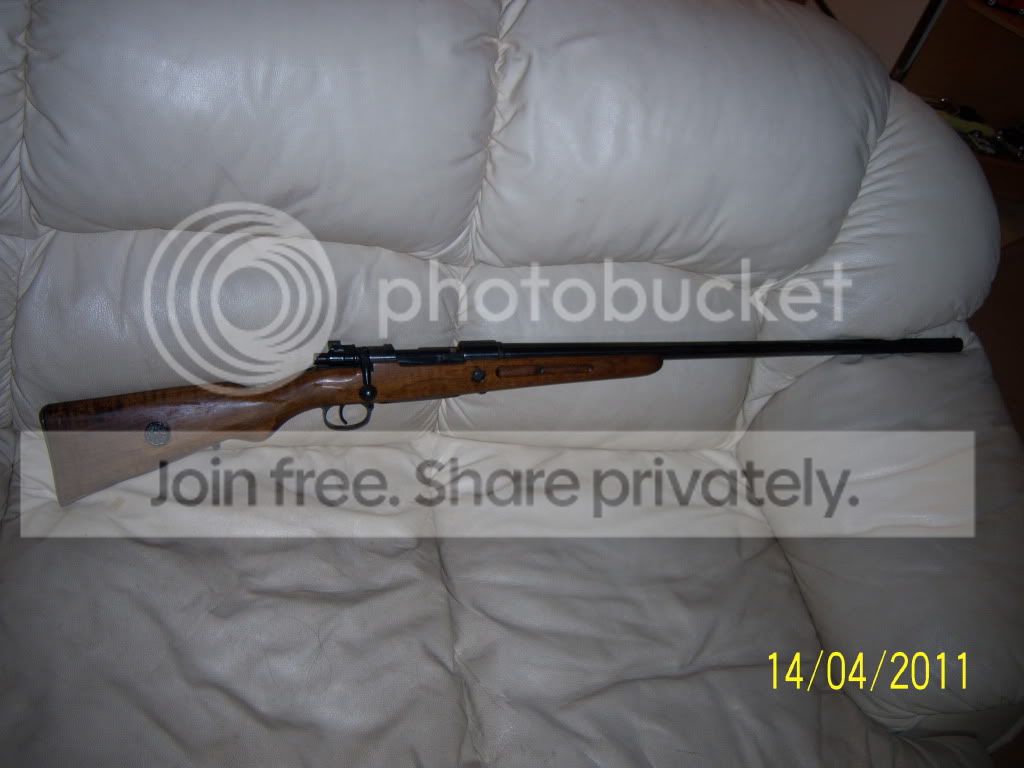

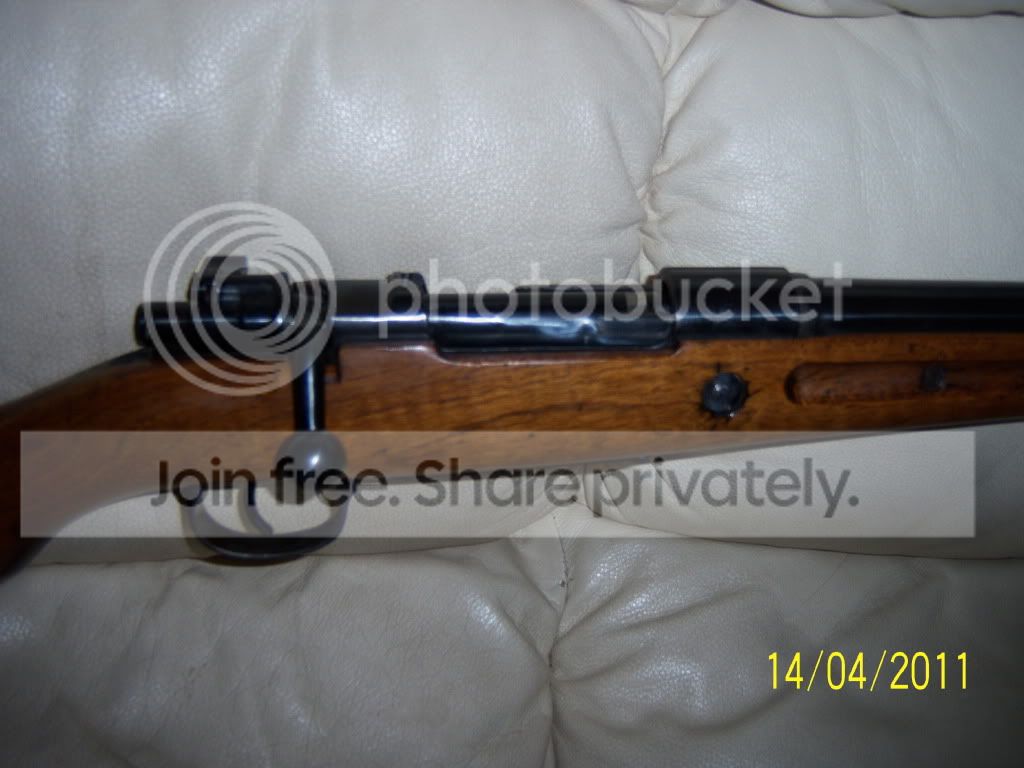

so picked this up at a gunshow in kamloops. the price was right and i kinda like that i had never seen a bolt action 12 ga before. its a mauser 98 rifle that was converted into a shotgun. it was a common conversion aparently to try to get post ww1 germany's economy moving. lets see if i can figure these pics out.

i had one of these, first thing, you dont foire regular 12 gauge ammo in these guns, they are short chambered in 2 1/2" shells
also at the front of the action there are 2 lock lugs, which when was a rifle there was a spot inside reciever for them to lock into, now with the larger chambering of 12 gauge, most of that lock area has been machined away
to alow the 12 gauge shell to pass into chamber, so it relies on the rear lock for saftey, they cannot withstand high pressure shells, typical walmart ammo or many of the "target " loads produce upwards of 10,000psi which is way higher than recommended for these, 5000-7000psi loads are prefered being the only 1 lug to lock bolt in, the bolt head is also only hung on by spring tension, and easily lost, and now impossibl to get so keep an eye on it
i loaded black powder loads for mine and it was ok
just some info to let you know of the gns capabilities
and also no modern slug loads or magnums in it either
pressures are to high

Oy, if all this is true, it doesn't sound like that great of a gun, except as a collection piece. Here I was thinking a Mauser 98 shotgun, would be an awesomely powerful action, and it seems to be limitted to black powder. Still a neat find, and a bit of history, though.
thanks for the info i had done some reading on them. mine has been modified for 2 3/4 i forgot to say that sorry. and i am aware of the locking lugs. its recomended when you buy these to inspect the lug closely and make sure it hasnt cracked. its mostly just a odd little shot gun that i dont plan on hunting with or anything. i have a cooey 840 as well. this one mostly hangs on the wall. i wish they where good enough for slugs like ryan said would make a good slug gun. but i think i paid 60$ or something for it so i just think its a cool different gun wasnt expecting much performance outta it :p

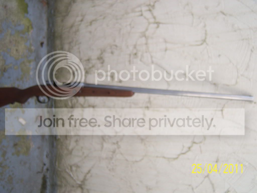

yea john303 im just not gonna shoot slugs out of this one as mine has a very tight choke. i have inspected the lug its in good shape im not too concerned about it. i have now completely disassembled the gun (barrel is still in recever its just not gonna come out) sanded and restained the stock today. started sanding the barrel (going to be polished steel) need to get some more paper and some more polishing compound. i actually like how it feels. thanks nathan i think its a neat gun too. ill post pics of it again once im done.

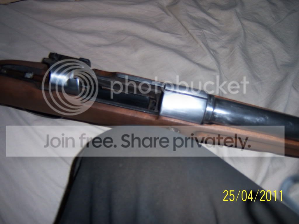

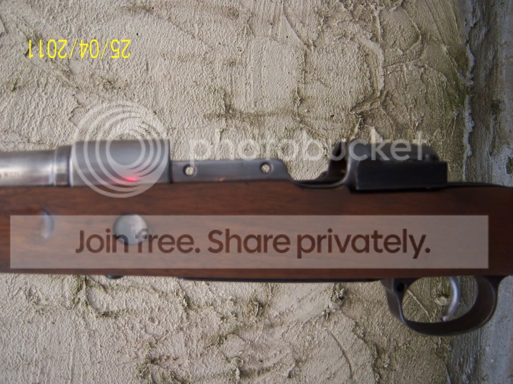

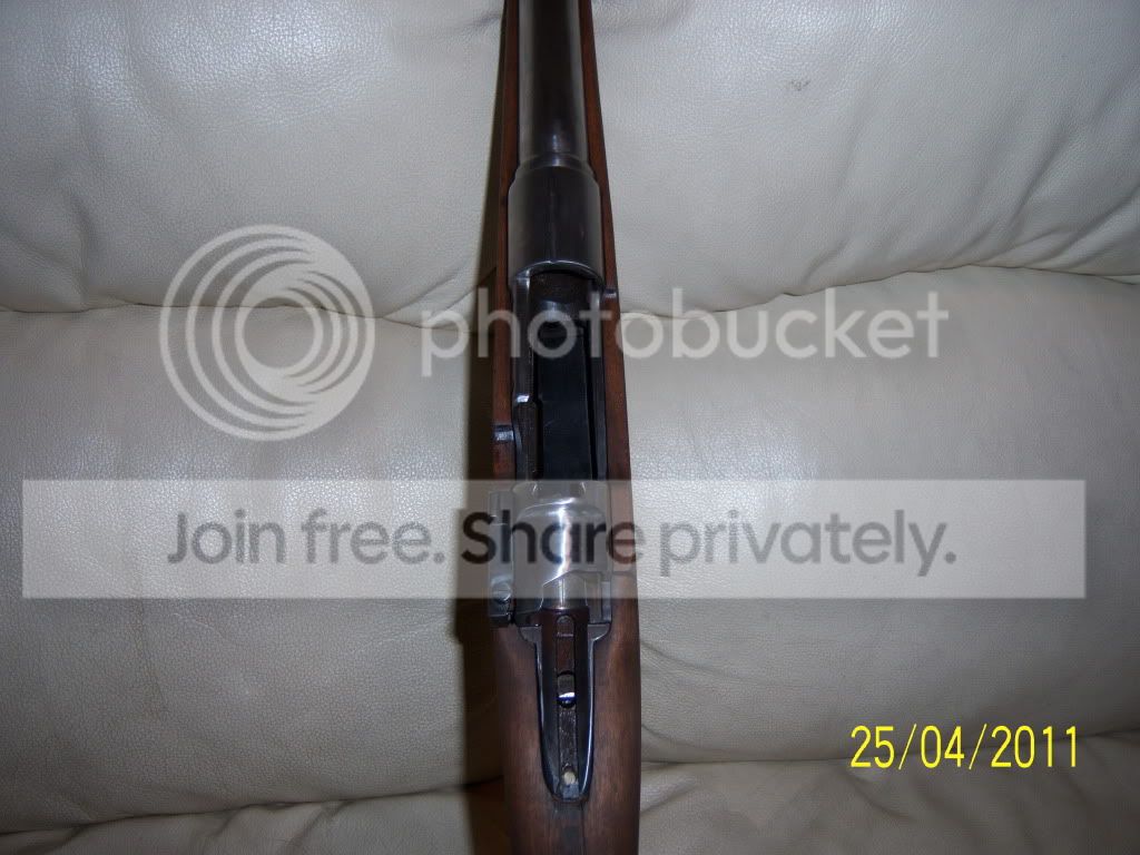

so the stock has been sanded down and re stained some of the metal parts have been wet sanded down to be polished metal. it still needs the stock to be clear coated and the steel is only sanded to 600grit need to go to 1000 then 1500 then polish maybe even 2000 if it dosnt clean up. couldnt help myself however so i put it back together to see what it is gonna look like and i am very very happy with it heres some pics.
sorry for the crap quality
Just couple more comments, on the 98 Remo which is a higher grade than Geha both in looks and mechanically, the bolt head is also held in place by a very small set screw. With the chokes on these guns don't shoot anything close up, won't be much to bring home. Just for fun do some pattern shooting. In the last couple of weeks there have been 3 Gehas for sale on EE. Nice work on the gun so far, it looks like you need an indexed front guard screw - Tradeex might have some. FWIW --- John303.
yea i took my 12 ga cooey out and compared spread to the geha. the geha has a crazy tight choke ill try to get some pics of it on cardboard or something. thats funny the remo's bolt head has a set screw my roommate actually sujested we add one to the bolt. there was another grade of these guns in between the remo and the geha called the "hard hit heart" from my understanding they where basicly all for export to here or the states. and thanks for all the positive comments i think its starting to look really good.

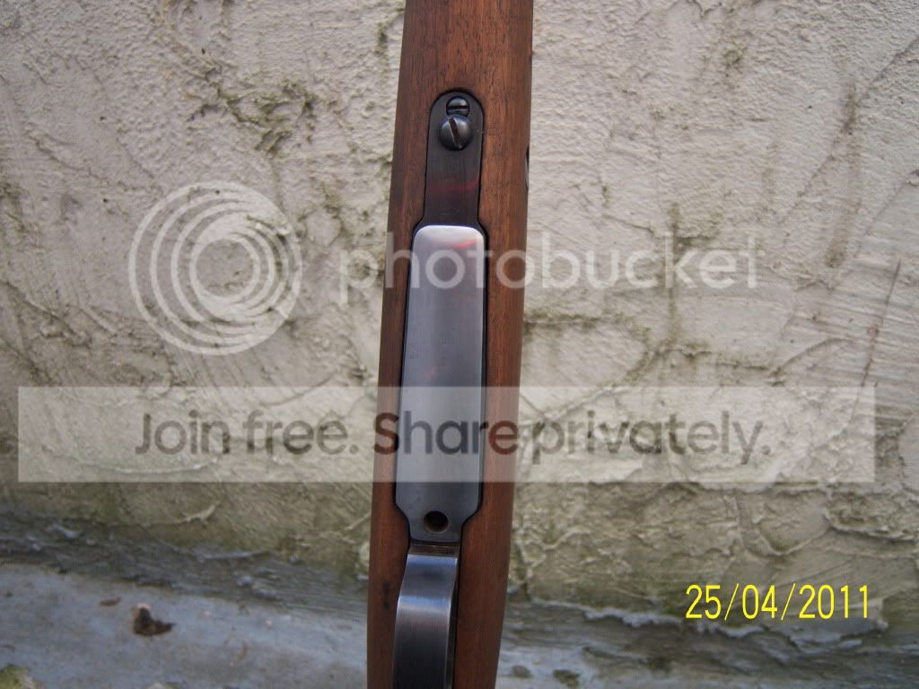

I read that many of these converted rifles were former Spandau made using sub contracted parts to help keep production as high as possible. I am guessing mine is circa 1917 at Spandau. Does yours have an intertwined "SH" marking on the bottom of the receiver (like the one in the photo) ?
i just looked and cant find that marking no. yours has wooden geha symbols as well aparently from what i read that means it is an earlier one later geha's has the symbol in metal on the stock. i would have left mine but the blueing was getting pretty thin in some spots and the wood had some good scratches in it so i refinished it all. now ive gotta break the bolt down and we are gona drill and tap for a tiny little set screw. proboly wont be for a little bit though im having fun shooting it lol.nice shot gun if its the same choke at mine you will have great distance with skeet
