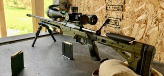

Was out today doing some zero confirmation/barrel seasoning and decided while I was going to the range I May as well send a few rounds through my Savage Axis II precision (30-06) and test some different ammo’s.
Well sent down 20 rounds of Hornandy white tail 180g. And it cycles fine but groupings were piss poor around 1.5-2”.
Then I loaded up some Nosler 165 grain ballistic tip ammo. Wow this stuff was dead on with great 3/4” groups. BUT!!!!! my god every round had me nearly having to beat the bolt open to extract the round. It would load fine and extract unfired rounds fine. But once fired the bolt was Jammed, you could lift the bolt like normal but could not pull the bolt back without excessive force.
Unfortunately didn’t have any other ammo with me to try after that nosler. I suspect the ammo was at fault being as the Hornady stuff function fine right before but figured I’d get a consensus here as well.
The brass looked fine after extracted and to the naked eye looked no different than the fired Hornady brass. I kept the hornady brass and tossed the Noslar stuff (Probly should have kept it to take some measurements with some calibers in hindsight).
