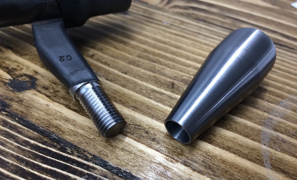

I do this on a CNC Mill, "turning" the old knob and thread milling in one set up. Same result as guntech's method, this makes for a strong, straight and true thread that is integral to the rest of the handle.
Cost is $100+return shipping and current turnaround is about a week and a half.

That's really nice work. I would suggest a proper threadmill if you want to do the op a lot quicker. it could be done in about 30 seconds with a multi-tooth threadmill.

Can that knob be knurled ?
Fatcatsdad: Sure thing! My knobs are built-to-order so design is entirely up to you!
Blastattack: You are absolutely correct! a multi toothed thread mill would reduce cycle time for threading. However, I haven't found cycle time to be the bottleneck in a case like this, set up time is. Current cycle time for threading is right around a minute and the same tool can be used to cut a variety of pitches... I tend to save my expensive thread mills for internal/production work.
