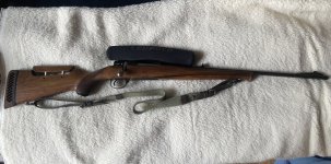

I’d have to say 30-06, clean and simple husqvarna 1640 22” barrel open sight topped with a 2.5-8 German 4 reticle scope in QD rings! Probably around 7.5lbs all in! And of course that is what I would have and use, but there is as many choices as there is people on this forum 😂! So get ready for a lot of different takes on the subject !!IMG_0684.jpeg
I'm with DGY on this one.
Husky 1640 in 30-06, iron sights on, topped with a 2.5-10 scope, but for me in a non-schnabel stock. Funnily enough, that's also what I already have. There is nothing more bombproof than a classic Mauser action but made with modern Swedish steel.

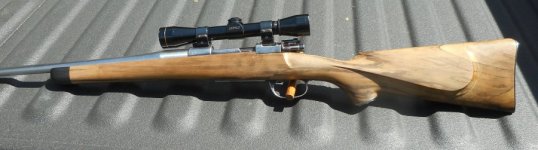

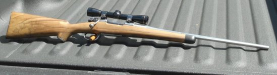

This is my interpretation of a do-all rifle: pre-war commercial Mauser action in .30/06, Shilen barrel. It's a work-in-progress here; since the pics were taken the checkering and stock finish have been completed. It's away now having the front sight put on. There will be a detachable rear peep that nestles under a trap buttplate. Bluing will likely have to wait till spring, I think I'll run out of time this year.
The choice of .30/06 might seem mundane or cliche, but it shoots flat enough for the plains and mountains, yet you can load it with 200 or 220 gr bullets and it can step up and handle bison and big bears, without obnoxious recoil or rifle weight. There's nothing in North America it can't handle, and very little world wide.
View attachment 1005378View attachment 1005379
Nice lines to that stock. Interested in where or who you got it from.
