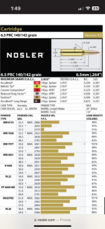

So , I’m just taking some measurements with my Hornad OAL gage and comparing to Nosler recommended OAL.
If I didn’t have the gage and was just using book value I’d be jamming the bullet into the lands by 25 thous.
Cases are FL sized.
I can’t close the bolt on either when measuring from Hornady and Nosler OAL data
What am I missing here?
This is the same scenario with 140 g accubonds and Hornady ELD X and two diff rifles.
