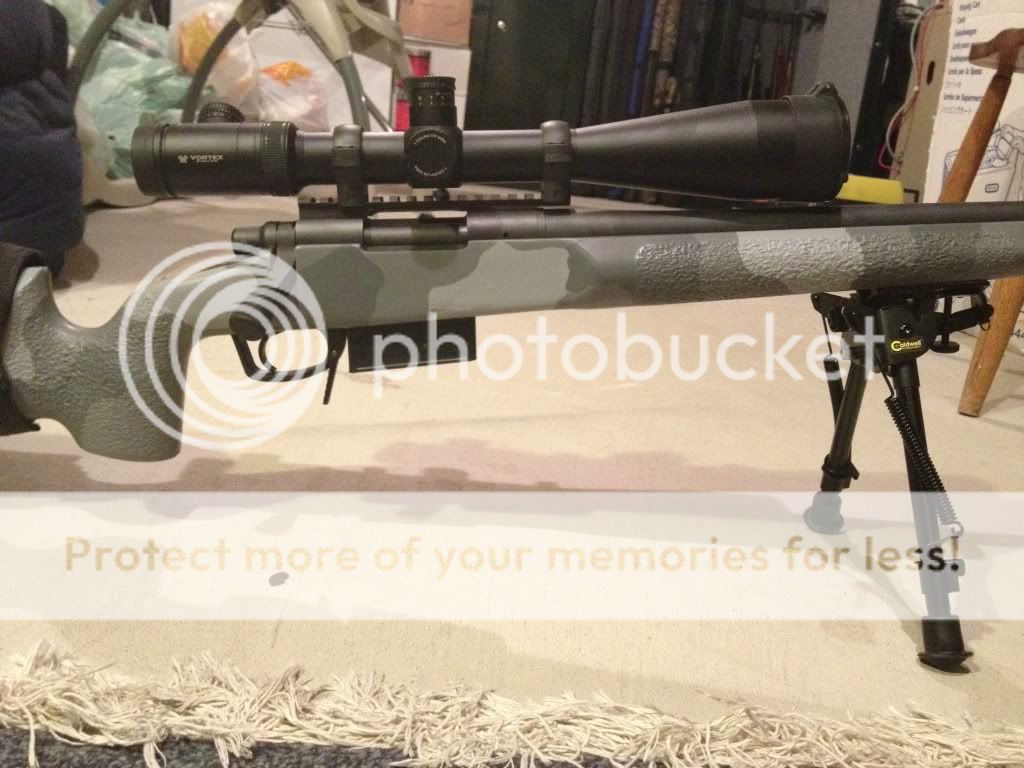

These are Casey's observations, and now they are mine. Here's a pic of my PTG bottom metal already installed....
That photo above is with the magazine in place. ANd yes this bottom metal accomodates the AICS magazines in BOTH .22-250/.308/.243/ .260 AND .223 formats
Have a look at the bottom metal with the .223 magazine in place...
