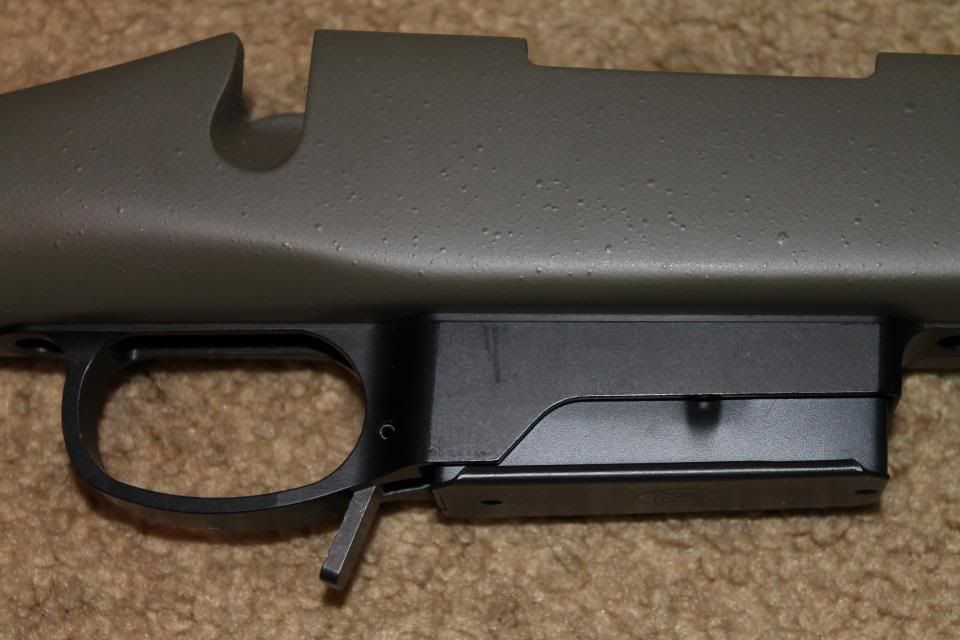

I use PTG Stealth bottom metal. It supports the mag below the bottom of the stock and the front lip can be pressed against a barricade instead of the mag, which will often cause misfeeds with flush bottom metal. Pressing the mag against a barricade doesn't cause any misfeeds with the Stealth. I would like an even longer front lip, and serrations/teeth, but unfortunately no one makes one. If you look at the literature for the new Ruger Precision Rifle, they have designed the front of the magwell with this in mind: http://i.imgur.com/DwJzn0N.jpg
I got the same stealth PTG one as well. Bought it last boxing week sale from PTG for $163US with a 5rnd AI branded mag. I think it's regularly $195.
I see they have a T-latch option as well. Hmmmm

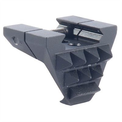

pod is too far forward...I use a noveske barricade stop on a rail just in front of mag well
