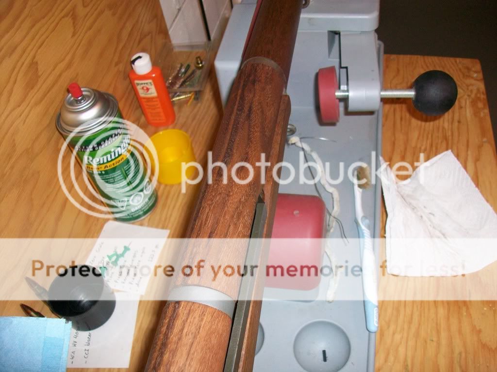

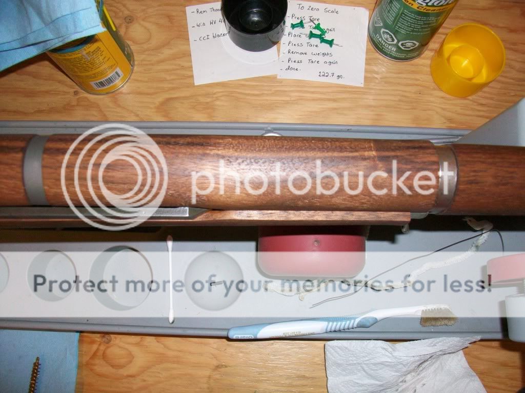

I installed a complete Boyd's finished stock set on my M1 tonight and noticed that the rear hand guard is about a 1/4 inch narrower than the original. Also when all installed the stock is about 1/4-3/8 wider on the hand guard on the op rod side of the stock, is this normal? My original stock set lined up perfect, as anyone else experienced this with a Boyd's stock set?
Maybe these photos will explain my question better.
The right edge of the guard should at least cover the top left side of the op rod to a point where you cannot see the inner edge of the op rod when viewed from the top. In your case there is a gap where one should not exist. It is probably still functional, but it is cattywhampous and doesn't look right. This cannot be adjusted to shift the guard to the right because of the need to fit the front end of the guard into the curve of the lower band. I'd contact Boyds for a replacement.

I thought something wasn't exactly right. Sadly I bought this stock set second hand so returning it for a new one isn't an option. I also noticed that finished hand guards are out of stock on there web sit, so no new one for a while. The rifle dose function fine, just doesn't look exactly right. Dose anybody have any tips to easily take the retaining clip off the hand guard?
