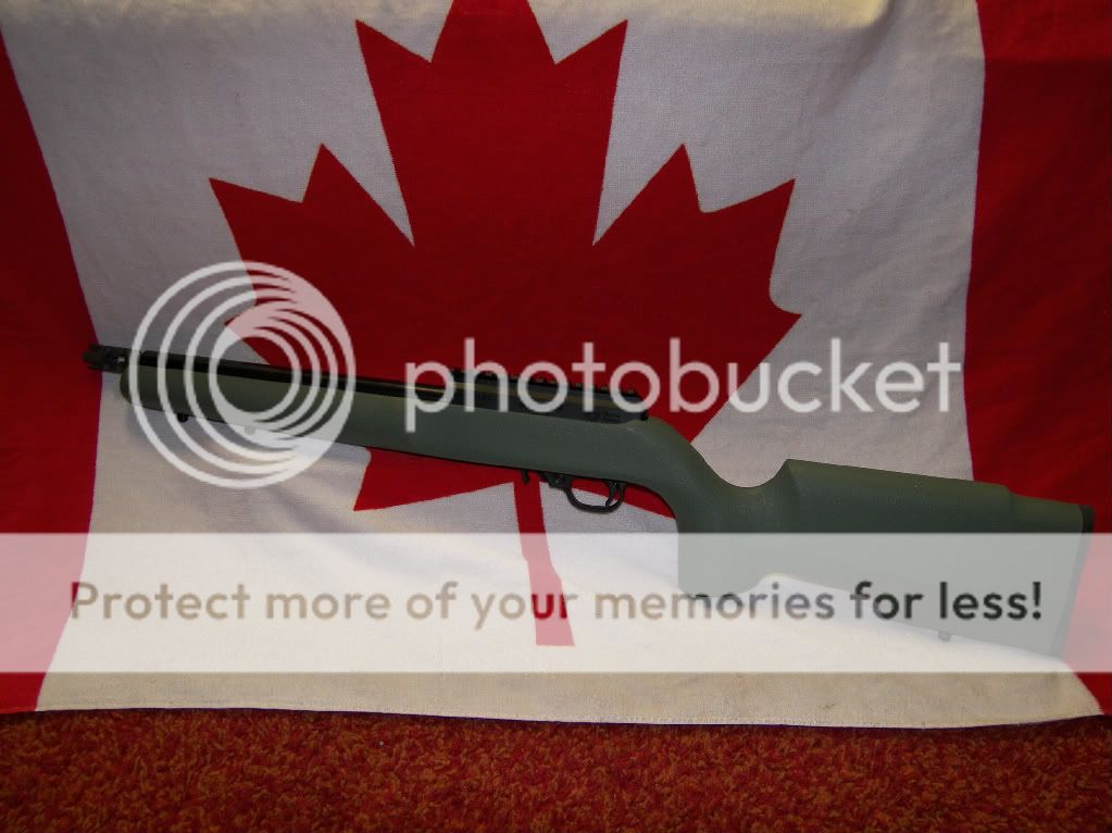

just got it today. the Dlask receiver fit nice, the barrel is a tad too short. had to put a brake on it. the ports are just at the end of the stock. oh well.
now to replace the stock internals......

So I finally got it together. I'll take it out to the range on Sunday, see what it likes to eat and bring back some tests out to 100yds. It all started with issues of running out of scope elevation.
Then some reading on other issues and fixs, then the Boyd's stock came out and then I noticed the Dlask reciever/barrels. I added some Burris signature rings, a Gunsmither V-block replacement to help address the barrel drop. I then bedded the Tacticool stock (I found mine fitting a bit sloppy) and a 20" fluted/threaded Dlask barrel, a Dlask reciever to address potential reciever hump(I don't know what the specific issue was with the running out of scope elevation so I took the scattergun approach to problem solving). Finally and Volquartzen High Accuracy group upgrade to the trigger group and a new ejector and reciever mounting bolt just because.
I've had this rifle for almost 20 years, this is the 3rd barrel and there's been a total of maybe 30 mags through all of them. Hopefully I can give this incarnation the attention it deserves.

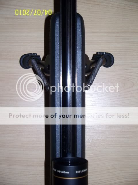

add a cheap bipod and the scope back on and its time to clean out the old mans pasture again:D

I zeroed out the scope and put a laser boresighter on it tonight. Over the length of one block (150yds?) it showed about 8" low so its promising. It was about 8 feet low before due to the v-block stresses on the sloppy Ruger stock reciever...
That should be no problem in swapping out some of the Burris Signature rings to make up the difference in elevation and allow the scope to stay in centred in its focal plane.
