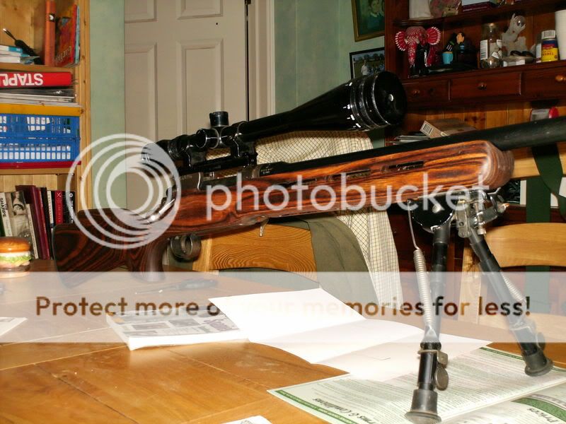

Cheers I have fitted the action and a bipod, my long range mate said that bedding is an option, I may bed it later in the year. I really have learnt lots with this one and now the oil has soaked in it feels really nice and not so shiny. I have considered waxing it to seal the outside.

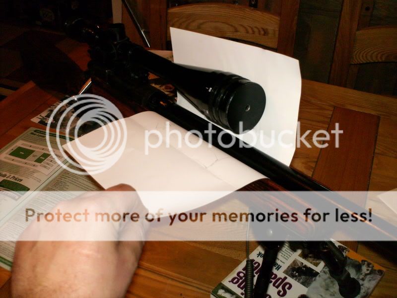

This last one shows the paper float test works. Its too dark by 330 pm to take pics so they can wait for tomorrow for the outdoors.

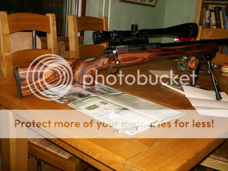

edited to add daylight pictures
[/IMG]
I cant seem to get good light
[/IMG]
