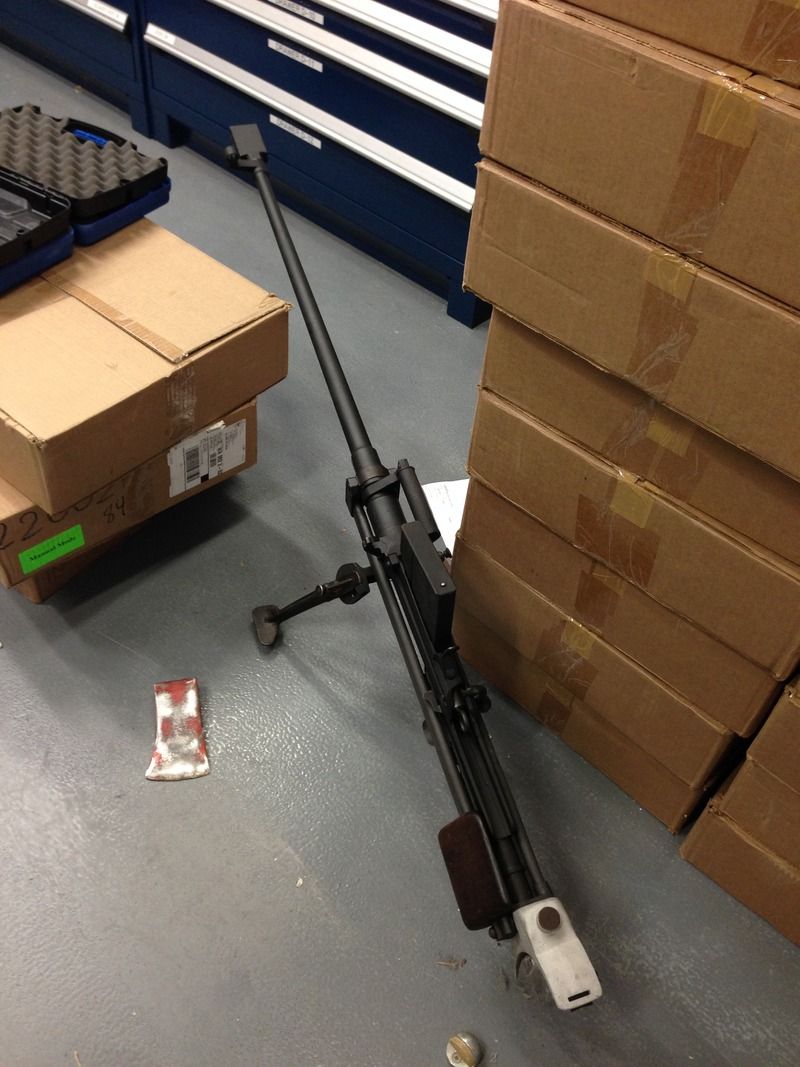

I had mine rebarreled this year. My work in progress was an Inglis Boys MkI with the rare carry handle, harmonica muzzle brake and bipod. I too used a M2 .50 barrel and it turned out great. I know that Ellwood Epps can do the barrel conversion but not to discredit his work but he may not taper the barrel and you may not get the full proper length as his lathe can not accomodate that length. Like Sten collector said, to top off the conversion, you also need to get a magazine converted so that you can load up five rounds of .50 BMG into it and then proceed to load, fire and repeat until empty. I've fired mine a few times since the conversion, around 40 rounds now. I seriously need to get into reloading for it.
Barrel in the white on the rifle.
Restored without the bipod.
Conpleted! Just needs a original or repro but pad!
Top view of rifle.
