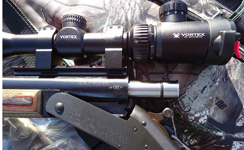

So I always wondered how accurate and useful these break action shotgun chamber adapter are. From reading on the Internet it is hard to tell … opinions range from totally useless … to small game killers at 50m. So what is the truth? How accurate are they? In order to find out I bought two 12ga to 22LR adapters. One 8 inches long and rifled. And the other 3 inches long and smooth bore (no rifling). The two adapters are from Short Lane Gun Adapters:

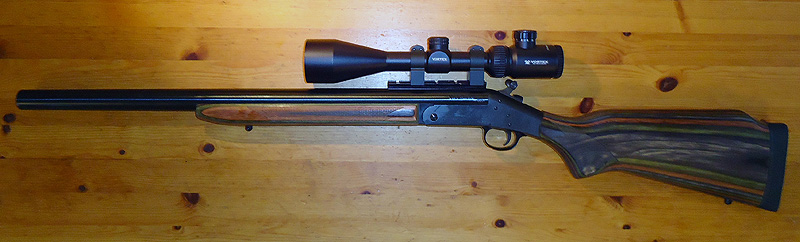

In order to test accuracy I was wondering how I would do this with just a bead sight on my shotgun … hmmm … how accurate can you shoot with just a bead sight? Probably not very accurate … right? And then I had an idea … will these adapters fit into my deer hunting rifled slug gun? Ten minutes later I had my answer: they fit nicely into my H&R Ultra Slug Hunter and which has a 3-9 x 50 scope. Bingo! That is pretty precise!

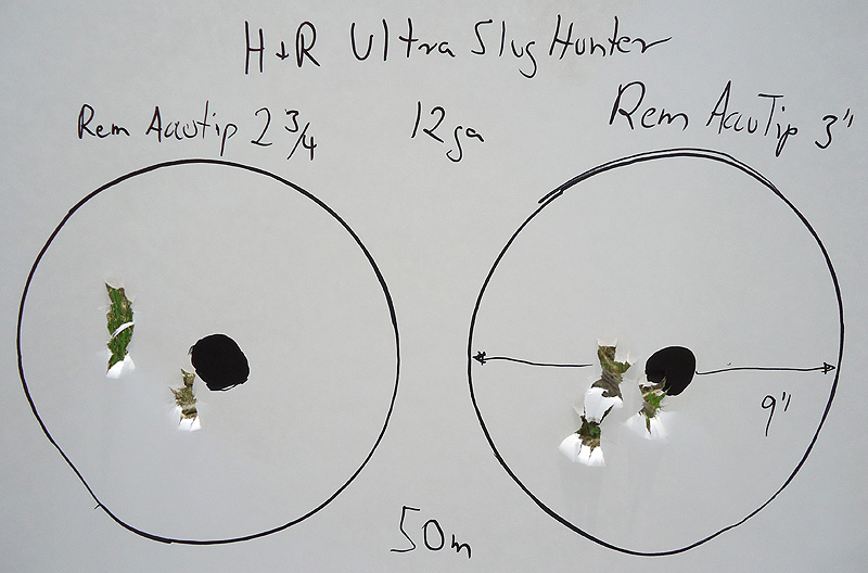

First I need to say that I sighted the scope in this year … and at 50m I am getting these groups. From the picture it seems I am off to the left a bit …

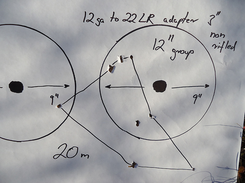

My first test was with the 3” smoothbore 22LR adapter at 20 meters. Here the result …. I got a 12” group at 20 meters. I guess that is not the sort of accuracy you need to hunt small game at that distance … My decision: that adapter will stay at home in the future and collect dust! :-(

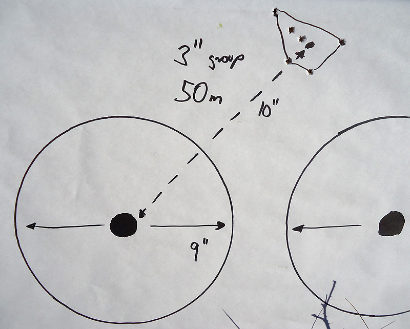

My next test was wit the 8” rifled adapter at 50 meters and I have to say I was surprised. First, I got a 3 inch group and I thought …”Wow, that is not bad!" However, second, the group was 10 inches off from where I was aiming at. Even though the grouping would be accurate enough I would have missed any rabbit I would be trying to harvest. :-(

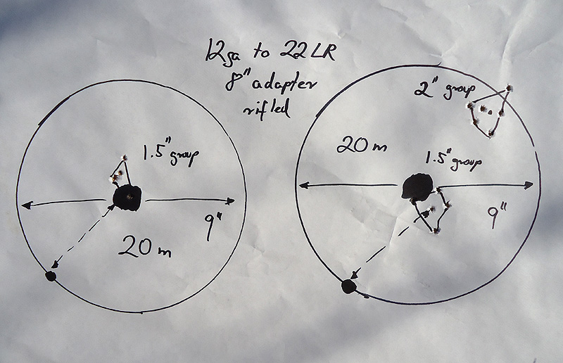

Next test was a 20 meters … and here is the result: 1.5 to 2 inch groups and point of aim off by around 4 inches to the upper right.
Ok, now might be the time to go into the details of how I used this adapter. Rimfire adapters are not centered but offset and I used mine always in the 12 o’clock position. The H&R Ultra Slug Hunter would extract the adapter after each shot so that I had to push it in after each shot. Further, I took the adapter out of the gun in between shooting the groups and the results were consistent: this particular adapter will shoot to the upper right in the 12 o’clock position, around 4 inches at 20 meters.
After I realized this, I adjusted my point of aim as you can see in the picture, and I got a nice centered group.
