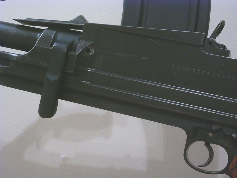

I just got it tonight and I have NEVER EVER SEEN PARKERISING DONE THIS GOOD BEFORE. Its flawless, no imperfections or blemishes, it does not bleed, the blasting was done in such a way that you can barely tell it had been done, the colours are deep and rich. Honestly it is by far the best parking I have ever seen. I,m blown away. I am planning on sending him everything I own that needs work.
I have had things parked before and with various results by various people who claim to know what they are doing but this turned out like nothing I have seen before. The gun now looks mint.

Pics as promised. Now keep in mind that the lighting was poor and the flash was used for most of the shots. When using a flash on a camera it will highlight all the imperfections on the surface it is capturing.
I also oiled the gun so this also adds to highlighting the imperfections.
Even with both of these used in the photos its still looks amazing and it is the exact same colour it was before I had it parked.
Enjoy the pics, I,m going to take some more and with better lighting shortly and when the oil is absorbed.
All I can say is the man the best parking I have seen. He even drifted out some of the pins so they would be the right colour.
Have a look at the barrel nut, the faint hand etched lot number is still visable. Also note the barrel itself, its not pitted like some blasted it with a unit full of gravel. You can barely tell it was blasted at all.
