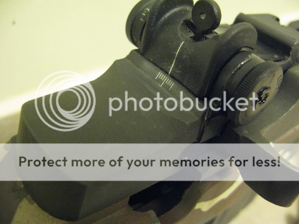

To index a barrel two straight edges are attached to the rifle as shown below.
One on the flat space on the heel of the receiver and one on a (straight) flashhider base.
The problem with trusting the flashider as an indicator for barrel index is, as you indicate, it must be straight. From what I have seen the majority of norinco flashhiders are not machined anywhere near precise enough to use them as an indicator for barrel index. In fact, I would say in most cases, what appears to be an out of index barrel is actually a crooked flashhider (offset splines and or angled dovetail) or canted front sight. I would only consider using the flashhider as an indicator of barrel index if it was an aftermarket NM or similar, assuming the Norc barrel grooves for the flashhider splines are true.

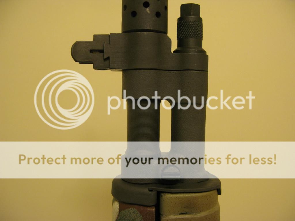

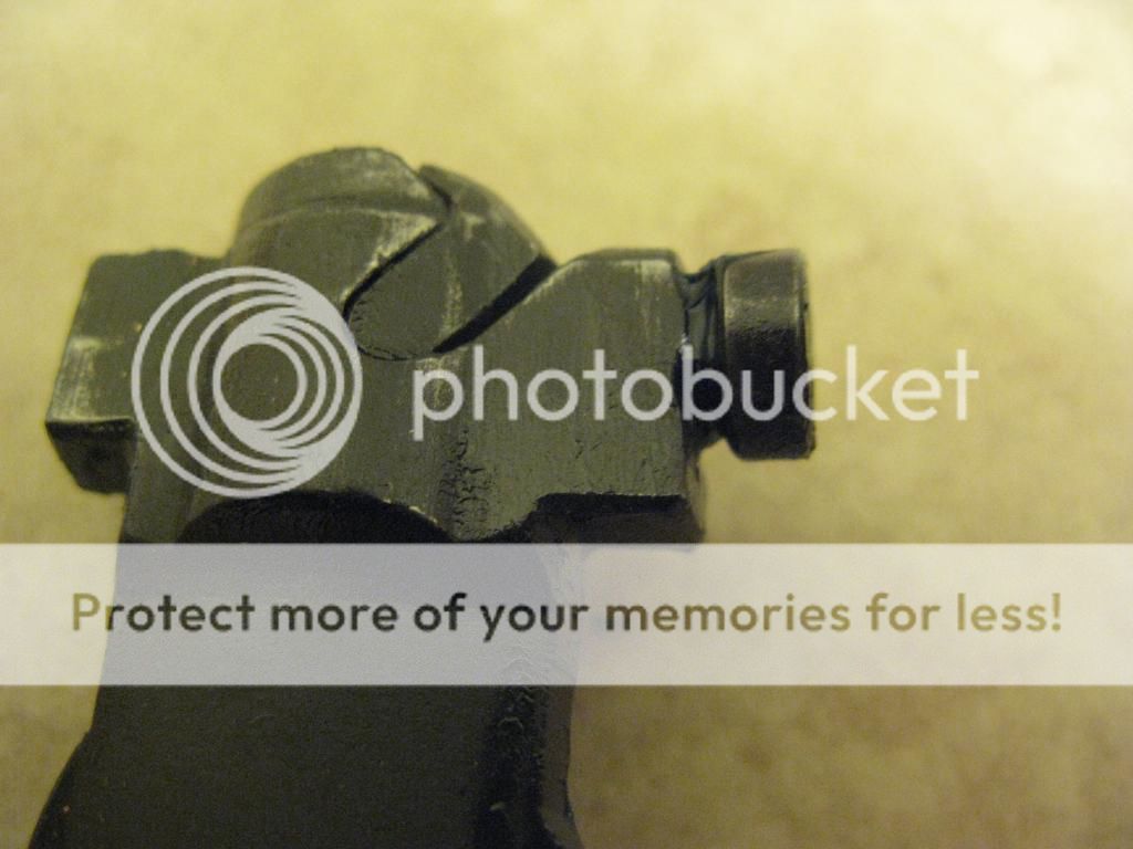

My sight base is exactly the same, is there any replacement part for this available online?
Contact Canam and they will send you a FTR..(free shipping label .) for the part and they will exchange it .
There are aftermarket ones out there as I bought another rifle with one on it already .... it was 22 inch barreled Norinco and the gas lock has a nicer finish on it but looks the same.
SEI makes one , Did you buy the rifle new ?
Brownells sells them but not sure if they ship them to Canada
h ttp://www.brownells.com/rifle-parts/gas-system-parts/gas-system-hardware/locks/m14-m1a-gas-cylinder-lock-sight-dovetail-prod25226.aspx
h ttp://www.nokick.com/SEI_M1A_Gas_Lock_with_Dovetail_for_18_Barrel_p/sei%20gl-dt-18.htm

The SEI ones won't work on the M305 - wrong thread. www .bitsofpieces.com offers a M305 Navy sight gas cylinder lock for the M305.
I would cut the upper part of the gaz key (metal saw or dremel wheel cutter)
Then work on the sight base so I can weld it at the front top part of the gaz assembly.
then grind gently the rest of the gaz key.
