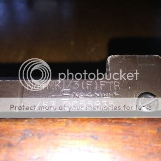

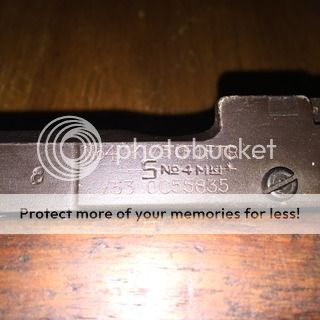

brit 303 question about stamp marks
Savage No4 MkI* as above post converted to MkI/3 in Britain in 1953. Conversion consisted of fitting a mark 2 trigger which was hung on the action.
Collector67 is correct in so far as that goes. Your rifle was Factory Thorough Refurbished (FTR) and I believe it was done at Fazakerly in 1955 (I could be wrong on the date and place). That means it was thoroughly inspected and brought up to current serviceable standards so it should be a good shooter. As with any old military rifle it doesn't hurt to have the head space checked.

Went through FTR in '53. From the serial number it is the 1,055,835th rifle made by Savage under Lend-Lease. That would date it toward the summer of 1944.
