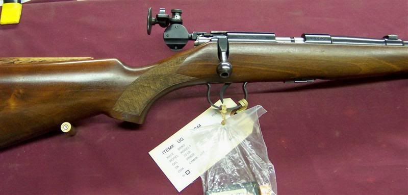

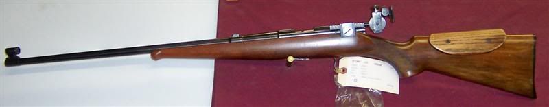

I'm a fan of the older Brno #1-#5's. The #1, #2 and # 5 are sporter guns and the #3 and # 4 are target guns. What I've noticed however are a lot of #1's kicking around for sale that were converted to target gun's. Were these purposely made up for some kind of sporter class target shooting or is it just a coincidence?

There was a target shooting program sponsored by CIL - Dominion Marksmen. One class was for sporter weight .22 rifles. The Brno sporters with target sights would have been set up for use in this program. Remington, Winchester, BSA, Walther, Tyrol, etc. rifles were used.
The earlier Brnos had trigger mechanisms rather like a Mauser. The later ones used a prop sear system akin to a Model 70. These are fine rifles, and among the few .22 actions that are worth using to make up a custom rifle. Fitting a new barrel to one is more complicated that rebarrelling most centrefire rifles.

Thanks. That answers my question perfectly. :)
