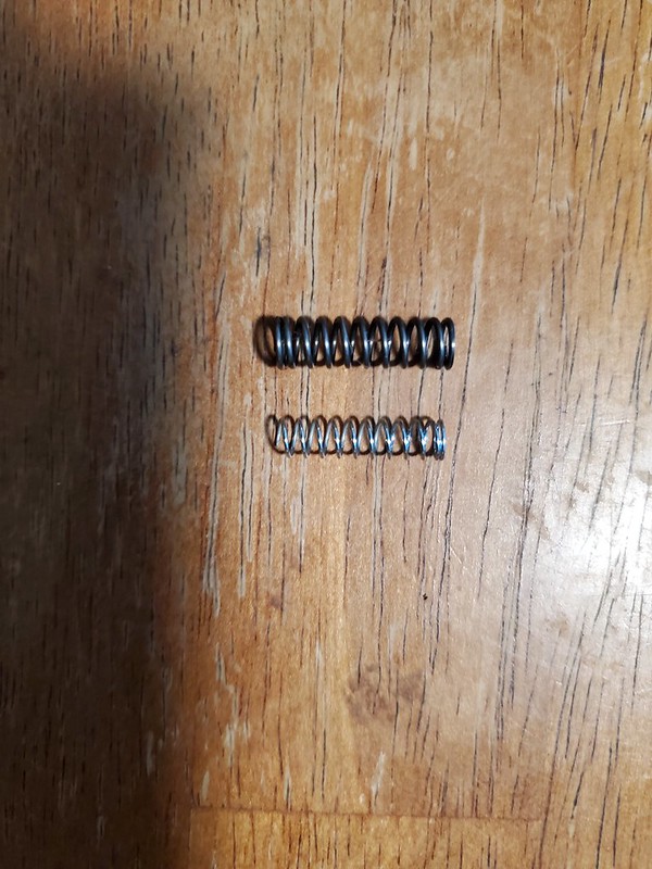

3. Replace the main spring. I knew that it is common trick to use the floor plate latch spring as the sear spring which I didn't want to do, but it did tell me that I can change weigh with a different spring and of course Google provided lots of examples of people trying this some with great success and others that failed or made things worse. I put a ball point pen spring in place of the sear spring to test what would happen. It did lighten the trigger, but it was a poor fit and the sear won't return full into place.
4. Go to Canadian Tire a pick out two of the same spring with similar dimensions but a little longer than the original sear spring. The main spring is very heavy duty and quite stiff. The new springs were similar in weight, but just a little lighter duty. So I cut the new spring to an length four or five coils longer than the original to attempt to replicate a similar compression weight to the original then proceeded with the following process: install, test, make a qualitative notes about the performance (I don't have a trigger pull weight gauge), remove, clip the spring, and repeat until I had got too short to work properly.
5. Select what I thought was best weight to sear engagement (about 2 coils longer than the original) and clip the other new spring to that length.

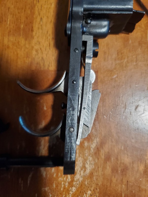

My second mission; adjusting the set trigger weight. The trigger pieces are pinned in place in the bottom metal and located in the middle of a large flat spring that is held in place by a large blued screw at the front of trigger group. Setting the set trigger results in the lifting and "loading" of the big flat spring which can cause the initial setting of the set trigger to actually require a fair bit of force. Once the set is pulled you loaded the force of the big spring on a mini sear piece that is released by the pull of the primary trigger. The force required to release the seems to be controlled in part by the little flat spring and the mating surfaces of the mini sear. Once the set primary trigger is pulled (or breathed on), the force of the big flat spring powers (really hard and fast) the connection between the DST system and the sear bar system. I didn't know where or how I could source a replacement for the little flat spring and I didn't want to start buggering with the physical shape of the sear so I decide my mission would be to adjust (ever so slightly) the angles of mating surfaces between the primary trigger and the little spring and the mini sear via the little screw between the triggers and the big blued screw. This was all fairly intimating because of how fine the surfaces were and minuet forces required to make the system work. So this is what I did:
1. Adjust the center screw (between the triggers) in and out to find the "heaviest" weight I could while still having the set work. If you screwed the screw in too far the set won't catch the mini sear when engaged.
2. I started adjusting the big blued screw holding the big flat bar in place. I discovered there was room to screw this in tighter (and looser). Tightening the screw increased the load on the big flat spring and changed the position of the little flat spring. Loosening had a similar effect but once loosened too far the little flat spring could move side to side and change it's connection to the rest of the trigger system. It was challenging to put in back in the correct position, but after some swearing and sweating, I had the big flat spring, the little flat spring, and the big blued screw back in the correct position (take lots of pictures). What I learned was that slightest changes in the little flat spring and big flat spring does change that weight and creep of set primary trigger.
3. Using the tiniest adjustments on the big blue screw between "pretty tight " (like my 2 year old wouldn't have the strength to move the screw) and really tight I search for the best pull. I would move the screw in "one hour" (like if the screw was the hour hand on a clock) adjustments from "really tight" to as a loose as I was comfortable with and tested the pull of the set primary trigger. There was a small but noticeable change in pull weight and feel ("creep", but not really creep because it is so light) over the test and eventually I came to rest on spot I thought was usable.

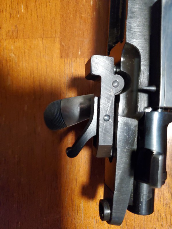

Here are a few pictures to help with the story:
