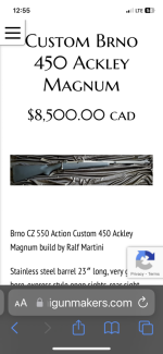

If you wanted a 450 you should bought something like this.
Well that one is a bit more then I spent on this one…..
For sure but call any reputable builder and ask what a sorted 450 would cost. trying to fix (I don’t think any reputable smith would even try and fix) that is just throwing good money away.
