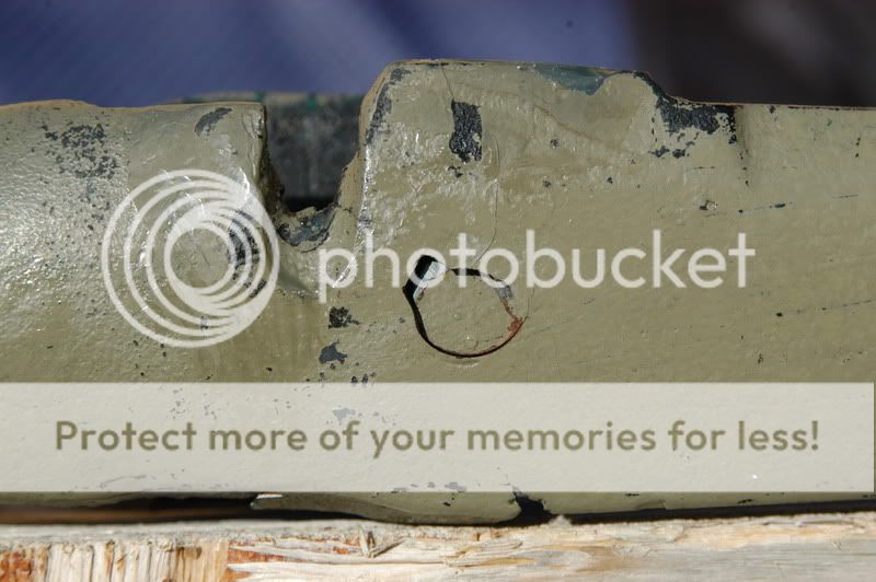

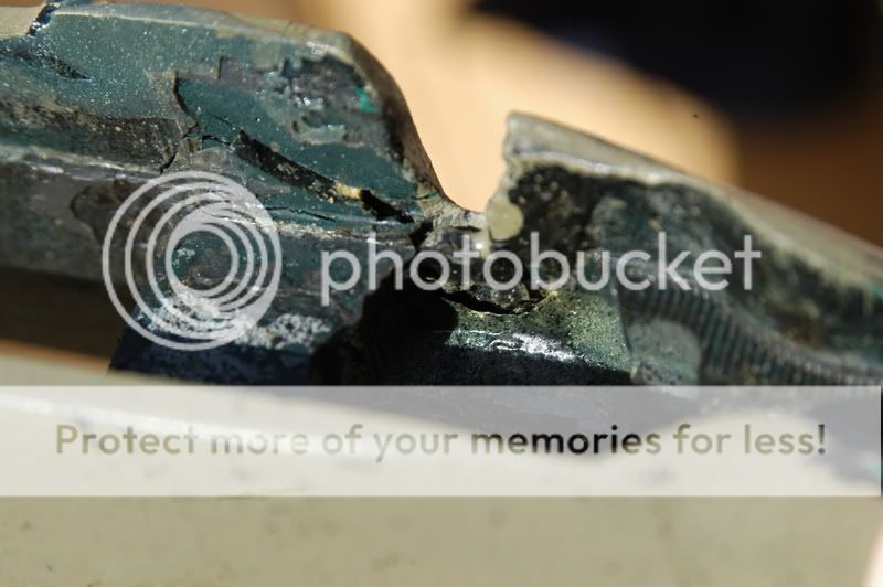

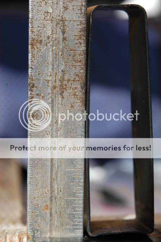

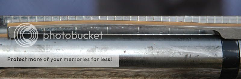

For those who missed it last time here are pics that show the results of the round going off in Pounder's 602 magazine.
The stock is cracked at the action
The cross bolts came loose
The magazine box is bowed, and although we didn't get a picture of it so is the hinged floorplate.
The ejector is bowed from gas flowing between it and the bolt body and there was a piece of brass from a cartridge between the ejector and the bolt body.
