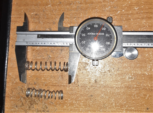

I love the tool. primed about 50,000 cases with it.
The spring around the primer rod broke.
The first time it broke was not a problem. It ran fine with the two pieces installed.
But now it broke again.
I emailed Frankford and they said this has never happened before and they don't have spare springs. ????
Looking for a 1.1" spring, about 0.3" OD

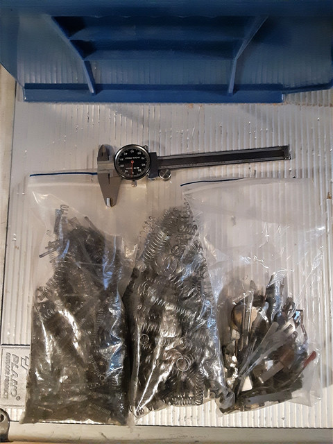

Goto the hardware store, they normally have racks of compression springs.
Should have something close.
#2 looks like a good bet.
I currently have a Colt hammer spring in there, which works with the skinny small primer ram. But it is too small for the large Primer ram.
