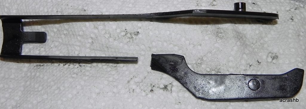

Shotgun stopped working yesterday during a match, now I know why: the lifter broke.
So first, is there any common cause for this? Was I doing something wrong, or did it just break because it was time to break?
Second, before I start googling, any pointers to a place that will likely have a lifter in stock ready to ship? 590s are fairly common, so I have some hope for a quick replacement part.

I broke mine, though not the same way, the roller pin snapped off. Mossberg sent me a replacement, but it took about 3 weeks. Came from the US free of charge under warranty.

Thanks! I just discovered the Mossberg Canadian service number, will call them on Monday and see what's up.
Didn't know the lifter / elevator was broken yesterday. Really no time to strip a shotgun during a match (or any good place to do it on range #5), and in any event a generous fellow shooter loaned me his shotgun to finish the match with.

My first thought was that I had missed resizing a round - this batch of hulls must have been first-fired in a loose chamber, and if not resized would stick about one time out of four.
As we now know, not the weather, not the resizing, not even the spanking, just good old fashioned metal failure.
Part came in, fits and works (at least with dummies) just fine.
Quick service from Grech Outdoors. $40 to my door.... I could have paid less ordering through the states but wait times would have been two-three weeks.
