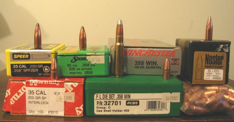

First you go buy some bullets:
Then you go look up some load data:

1) 250 gr Speer spitzer s.p. over Accurate 2015, start at 38gr work on up to a max of 42gr, will kill everything in BC.

I shoot 3 358w's and load developed for bro's blr. Only deer with them so far. All of them like 250gr Speer HC's and H335 at 2150 to 2250fps depending on the guns likes.

Spear 250gr HC bullet is excelent "heavy brush" performer for my Win mod 88, but 225gr Nosler partition would give you more flexibility and extra 50yds or so range in open clearcuts. H 4895 should give anything you could ask for from a gunpowder, and then some. Being temperature insensitive is a big bonus.
