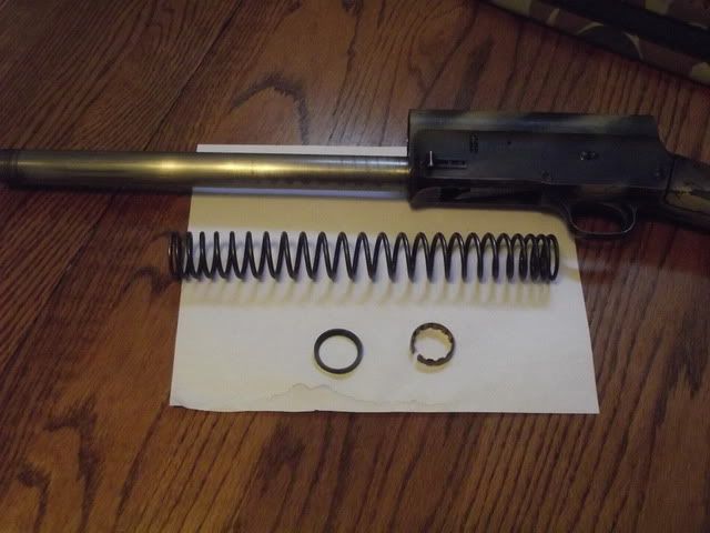

My buddy dropped off his old Browning A-5 and said it was having ejection issues. He thinks the ejector was worn and knew I was going to be going by the smith's so I'm gonna drop it off.

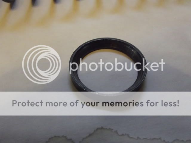

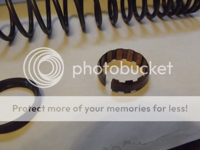

I got looking at it and doing some reading, seems it may just be missing some friction bands? It's a 1976 3" magnum. Am I right that it should have 3 friction bands and 2 steel rings? It seems to only have 1 band that is beveled on both sides and one steel ring. I'm not too familiar with these guns so all of my info is just what I got from googling the problem.
Here's the parts I have

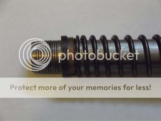

Here's how they were set up
The mag tube is pretty dry so I was going to lube it up well and try it out on Sunday, but looking on some input about these friction bands. Do I need to tell him to order a couple parts?
It should have 3 of the steel Friction Rings and 2 of the bronze Friction Piece. The rings in the pic are assembled wrong, the Friction Piece goes against the barrel and the flat side of the Friction Ring goes against the Recoil Spring. Lube the mag tube sparingly and do not shoot magnum loads, 2¾ or 3", until it is set-up properly.
