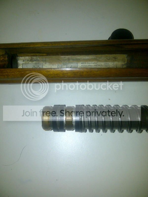

Had a beautiful A5 dropped off here last night, I see a bunch of spacers in here as well as a diagram as to how to use them. Unfortunately the diagram is pretty wore out and not usable.
Can someone explain these things to me, or direct me to a source that can help me figure them out?

In the photo you are showing,it is set up to shoot 3" loads.remove the top brass ring and the next 2 spacers and it would be ready to shoot 2 3/4 loads.
pay attention to the 2 spacers and how they are placed against each other,flat sides together,taper towards brass ring.
Once the rings are set correctly, you can further fine tune it by the amount of lubrication on the magazine tube. Always, only use just enough oil for it to function.
