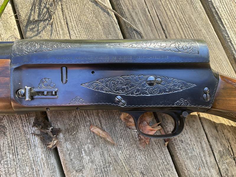

It is well known among the auto 5 aficionados that over its years of production , starting before the first war, the F.N. offered 6 types of engraving. The types 2, 3 and 5 were never commercialized in North America. During those years the type 3 went through 3 engraving patterns. Among the three generations, the second one is the most obscure regarding the date of commercialization and the engraving pattern. S&V on page 164 wrote "The FN photography archives for March 18, 1922 reflect engraving changes in the Types I, II and III but there is no indication of the effective date of change." After 10 years of collecting the auto 5, I have never seen any example resembling the ones shown in S&V on page 165. However picture 2 appears to be a 1923 or prior type 3, because of the curvature of the trigger. Unfortunately, it doesn’t resemble the one depicted in S&V book. If any of you have a second generation as per S&V picture on hand, it would be greatly appreciated to see it. Also, any literature would help to clarify the elusive 1922 type 3.

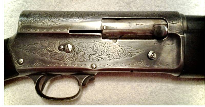

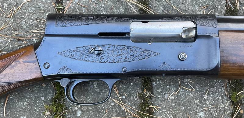

Picture 1
First generation type 3, this example is a 1919.
Picture 2
Second generation type 3, from the trigger curvature this example is a pre 1923.

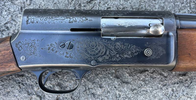

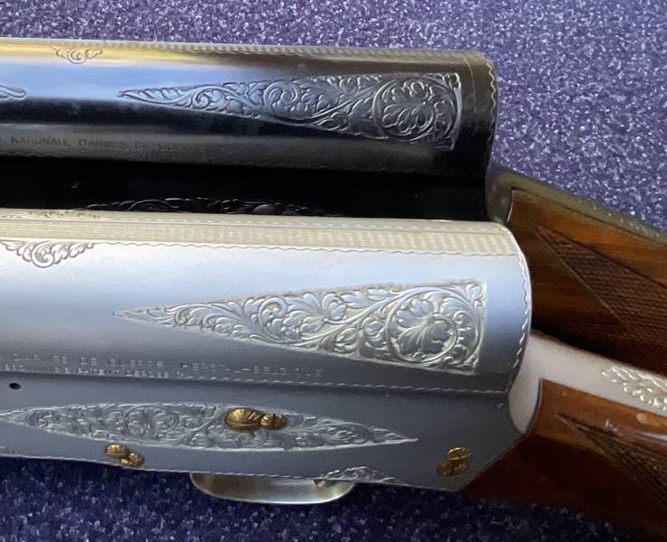

Picture 3
Third generation type 3, this example is a 1959.

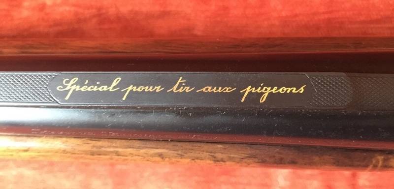

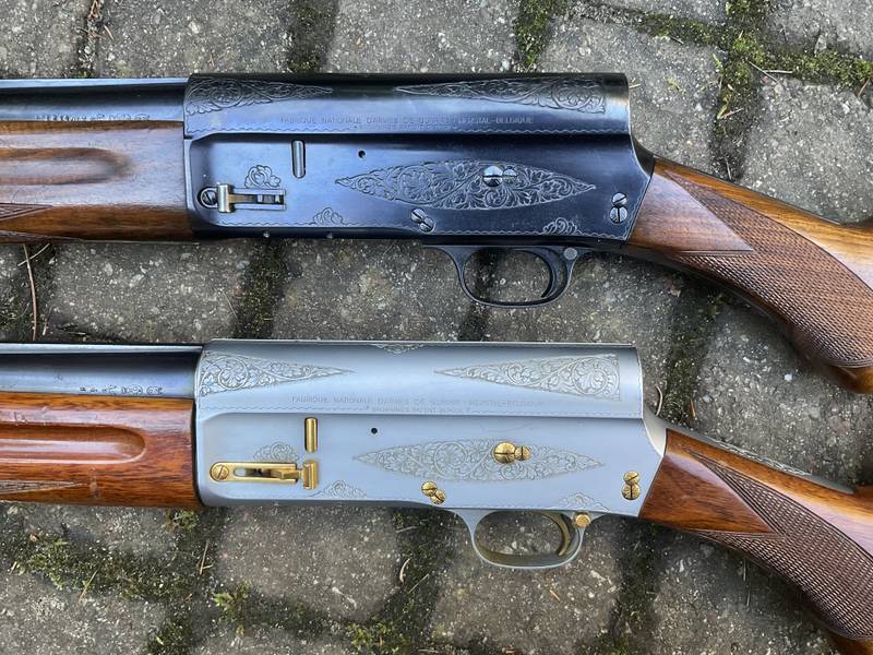

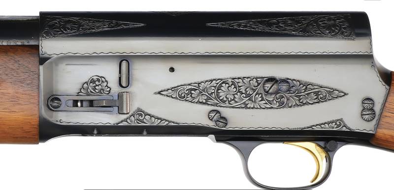

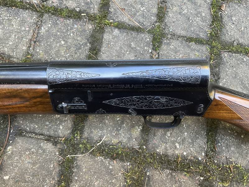

Picture 4 and 5
"Spéciale pour tir aux pigeons" with his type 3 engraving.

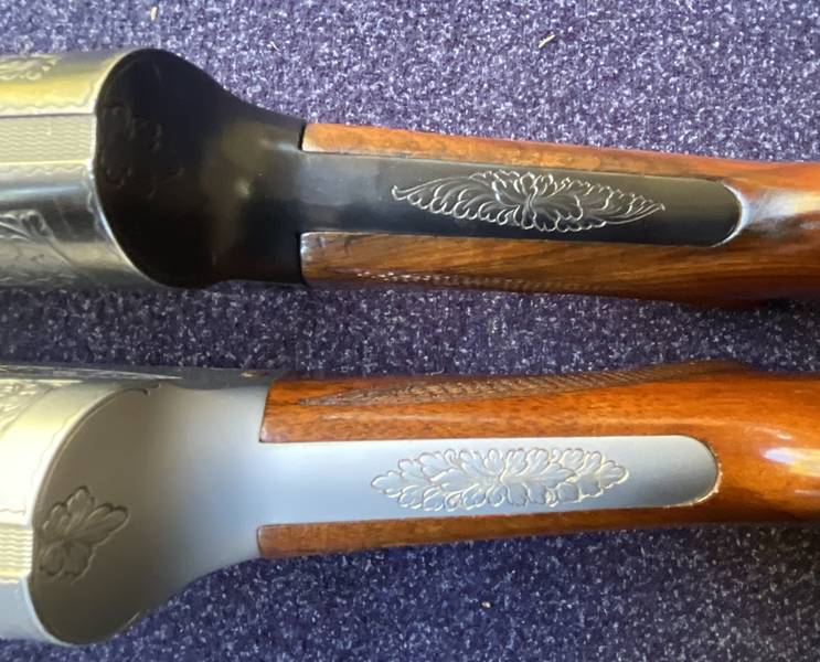

Picture 10
Notice in this foliage engraving how the engravers have interpreted differently the same engraving theme. The differences are subtle.
Picture 11
The differences are more obvious on the tang.
