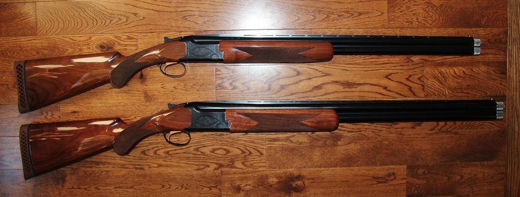

Here is a picture of the work that Vic Tomlimson did on my 20 gauge Lightning recoil pad... it fits exactly like my 12 gauge now.
