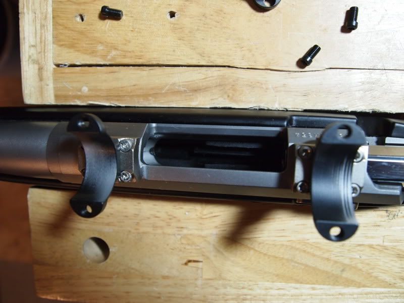

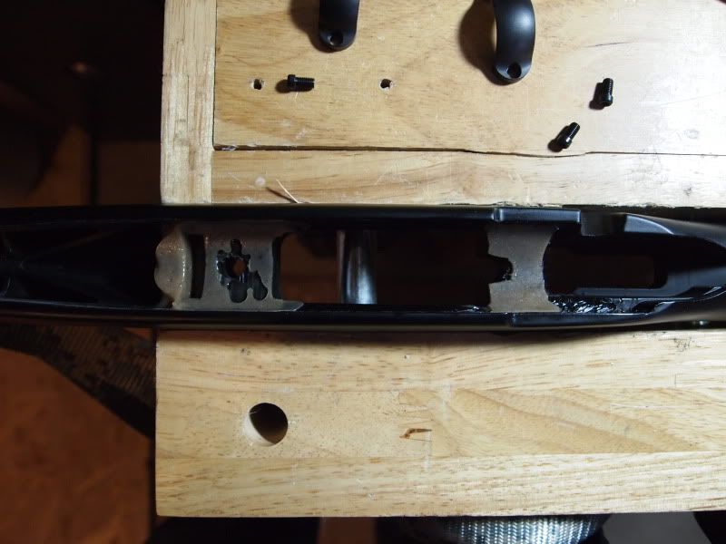

I took the action out to clean the rifle and stock and check the fit. As you can see Browning glass bedded the action. Even in a synthetic stock, it was done which is really nice to see. Some guys will argue that it isn't required in a Synthetic but I personally think that this feature won't hurt and is definitely value added.

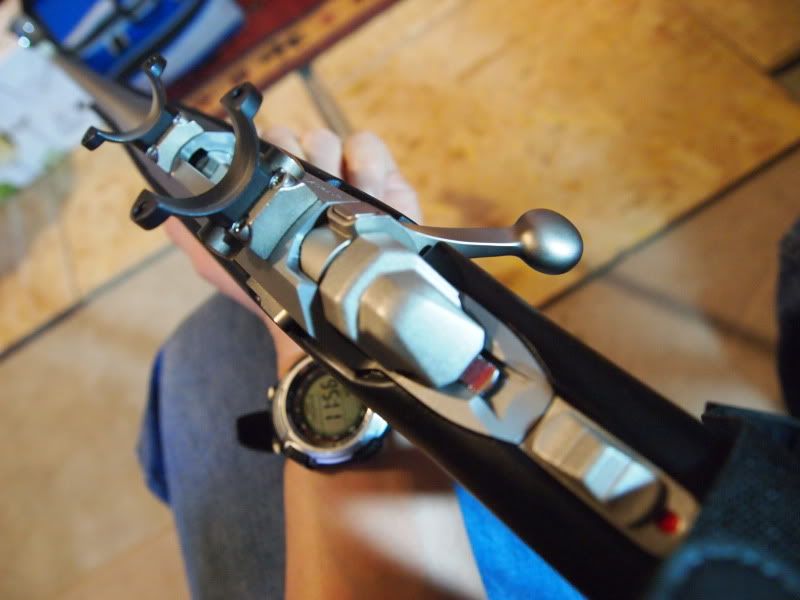

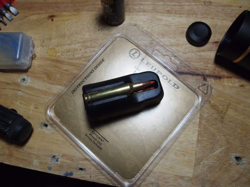

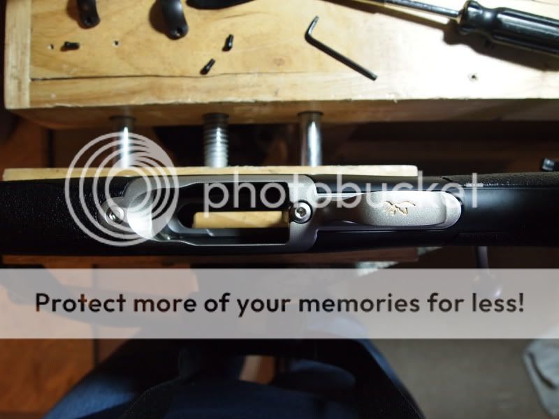

What really sold me on this particular rifle is that the action is a super-small action. Similar to the CZ527 Micro Action, it is perfectly fitted to the 223 Rem round and requires no spacers. No wasted movement working this action! I also liked that the magazine had a little bit of room for longer bullets but with a 1-12" Twist I don't think I need to worry about super long bullets.

Magazine:

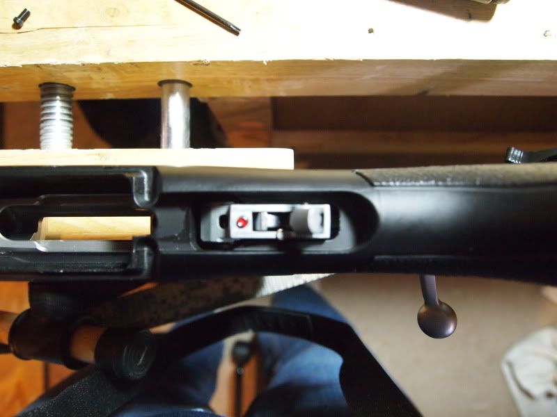

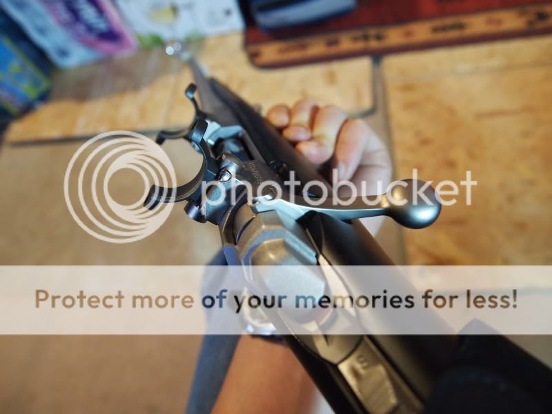

I looked over the safety of this rifle and noted with some great satisfaction that the safety is located on the tang. Beneath the shroud there is cocked action indicator and that the bolt handle contains a nifty bolt release for when the action is cocked. In essence it gives the user the ability to either take the weapon off safe and work the action normally or leave the weapon on safe and depress the bolt release to remove a live round from the chamber. It is nice as there is no wasted movement (Rugers/Winchesters with wing safeties force you to move through all 3 positions - Remingtons/CZ only have two positions) when you want to drop an animal. To work the safety the hand also doesn't have to leave the pistol grip.

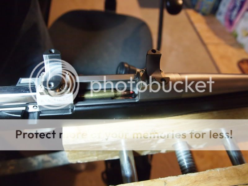

After playing around with the rifle, I decided to install the scope. I purchased a brand new Leupold VX3 3.5-10x40mm Boone and Crockett for this particular rifle. I decided to go with the Leupold Std Rings/Mounts as the 223 doesn't recoil heavily and they look perfect on this particular rifle. The Scope:
After installing the rings, I proceeded to lap the rings. Many will argue with new CNC manf techniques that this isn't required but I have a lapping bar it only takes a little bit of elbow grease to ensure that your rings are not permanently marred. If you notice, I did remove some material from the rings when I worked the lapping bar. I also like to lap as it ensures that the rings are perfectly straight on the rifle.

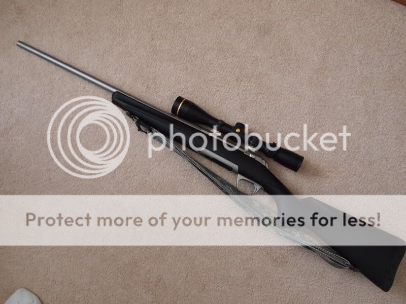

I had also mechanically zeroed the windage on the scope to ensure that the rear rings were at mechanical zero and installed the scope. I then installed the Browning Army Digital Pattern Sling and called her good.
Complete Rifle Right
Complete Rifle Left
