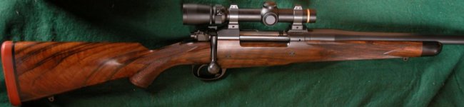

I was given a similar rifle from my Dad also in 30 06, He bought it new in 1952, I eventually gave it to my Son and He also put it in a Boyd's Prairie Hunter. It is now our "spare rifle" on hunting trips.
