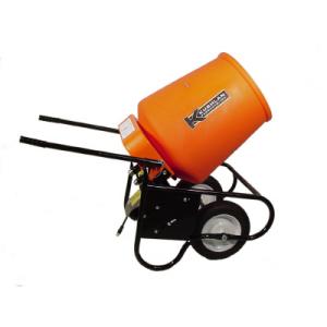

Saw a guy around here who has a small electric cement mixer that seems to do a pretty good job on mass quantities of brass.

too bad i am not located in a more central location....i have a 35 gallon electric mixer that i used to use for a parts washer, now it is a bulk brass tumbler, takes 5 large bags of corn cob media and 10lbs. of ceramic stones. not sure of the capacity yet, but 3 - 5 gallons pails of 223 cases just disappears into its bowels..........
i think storm and i will have to have a tumble-off someday.....lol
