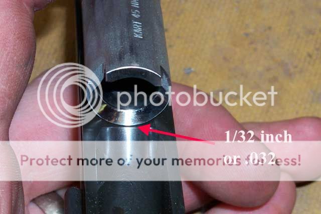

Is your barrel ramped? Lock your slide back and check the feed ramp on the frame to the throat or ramp on the barrel. If the barrel's ramp/throat is extending beyond the feed ramp on the frame, you got probs. Did you buy this used or first owner?
This is good:
This, not so much (notice the barrel overhanging the feed ramp):
