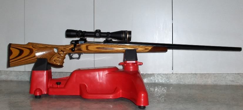

XR-100 is what amounts to a Rem M7 solid bottom single shot with a gorgous Laminated thumbhole stock and a target trigger.:)
That would be my choice.....biggest bang for the buck......forend is a bit rounded but nice......
